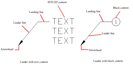

A leader object is a line or a spline with an arrowhead at one end and a multiline text object or block at the other.
In some cases, a short horizontal line, called a landing, connects text or blocks and feature control frames to the leader line.
The landing and leader line are associated with the multiline text object or block, so when the landing is relocated, the content and leader line move along with it.
