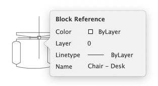

Rollover tooltips display current values of certain properties when the cursor hovers over an object in the drawing area.
The following properties are included:
- Color
- Layer
- Linetype
- Block Name
