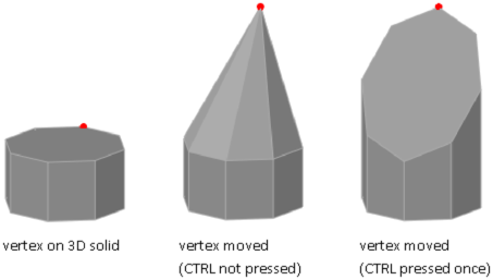

Vertex Modification Options
As you drag a vertex, press Ctrl to cycle through modification options.
  • Move Vertex. When you move a vertex and press and release Ctrl once, adjacent planar faces might be adjusted.
  • Allow Triangulation. When you move a vertex without pressing Ctrl, some adjacent planar faces may be triangulated (divided into two or more planar triangular faces).
If you press and release Ctrl a second time, the modification returns to the first option, as if you had not pressed Ctrl.
