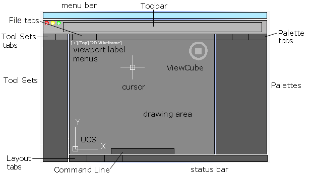

Parts of the User Interface
The user interface displays palettes and bars around the drawing area. Also, several controls are displayed within the drawing area.
