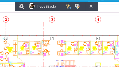

2D Graphics: Below is a list of improvements that have been made to the 2D graphics system.
  • TrueType font display quality is improved
  • Pan performance is improved for drawings with raster images or wipeouts
  • Display performance is improved for trace background and ViewCube
  • Layout switching performance improvement
