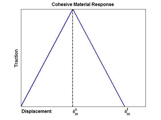

A typical traction displacement curve is shown below. Damage initiates at deltam supo where D=0, and then damage continues to evolve to the point where D=1 at deltam supf.
traction disp
Displacement Based Damage Evolution
For the displacement based damage evolution criterion, argument 10 is interpreted as the difference between the effective relative displacement at complete failure, deltam supf, and the effective relative displacement at damage initiation, deltam supo. Valid values must be greater than zero. The image above shows qualitatively how deltam supo and deltam supf relate to the rate of damage evolution.

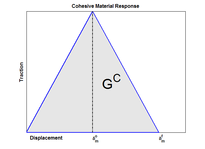

Energy Based Damage Evolution
For the energy based damage evolution criterion, argument 10 is interpreted as the total fracture energy of the cohesive material, GC. The image below shows how GC relates to the traction-separation response of the cohesive material. The value of GC you supply is used to determine the final relative effective displacement as:
deltam supo
where teff is the effective traction at damage initiation.
