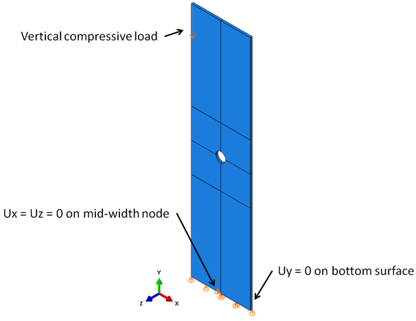

The model consists of a 6 x 1.5 in. plate with a 0.125 in. radius hole located in the center of the plate and uses fully-integrated SOLID185 elements. The layup is [45/-45/0/902]S and the ply thickness is 0.005 in. which results in a plate thickness of 0.05 in. The initial temperature of the plate is modeled at 72 °F and the test temperature of the plate is 140 °F. In the first analysis step, the temperature of the plate is increased to 140 °F. In the second step, a displacement controlled compressive load is applied to the plate until ultimate failure. It is strongly recommended that thermal loads be applied in a step prior to mechanical loading as the thermally induced displacements can cause a large shift in the load-displacement curve, which can make interpretation of the load-displacement curve cumbersome. The loading and boundary conditions are shown in the picture below. In the picture, the 0° ply orientation is aligned with the global y-axis.
loads and bcs
The specific initial and final model temperature values are dependent on whether thermal residual stresses are included. If they are included, the initial temperature value must be the actual initial temperature and the final temperature must be the actual final value. This is due to how Helius PFA calculates the ΔT from the stress-free temperature to the temperature of the model. If the residual thermal stresses are not included, the initial temperature of the model should be 0 R and the final temperature should be the ΔT between the temperature the material was characterized at and the final temperature. As an example, the table below lists the initial and final model temperatures for the four models used in the current problem. For further information on the calculation of ΔT, refer to the Thermal Residual Stresses section of the Theory Manual.
