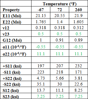

The majority of the properties are from the Composite Materials Handbook (MIL-HDBK-17-2F) [1]. The remaining properties are assumed and were determined based on typical values [2] for carbon/epoxy unidirectional materials. The table below shows the material properties with the assumed properties in green.
material properties table

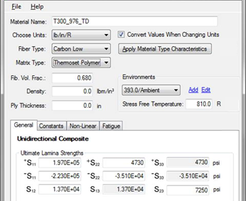

  5. Fill out the General tab by entering the lamina strengths for -67 °F given in the table. The GUI should appear as shown below.
    general tab

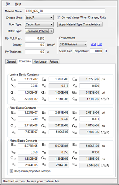

  6. Fill out the Constants tab by entering the lamina stiffnesses for -67 °F given in the table. Click the Apply Material Type Characteristics button to apply the default fiber and matrix stiffnesses. The GUI should appear as shown below.
    constants tab

  8. Fill out the General tab and the Constants tab by entering the lamina strengths and stiffnesses for 72 °F as provided in the table above.
  9. Repeat steps 7 and 8 for 260 °F (720 R).
