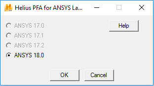

  1. Open ANSYS Mechanical APDL using the Helius PFA for ANSYS Launcher tool (shown below). This tool launches ANSYS with the necessary environment variables to run Helius PFA with ANSYS.
    • This tool is installed with Helius PFA and is found on the desktop. It can also be located at the following path:
      %install_dir%\bin\ansys-helius-launcher.exe
      ansys launcher
  2. Click the Run button in the ANSYS Mechanical APDL Product Launcher. The ANSYS GUI will appear.

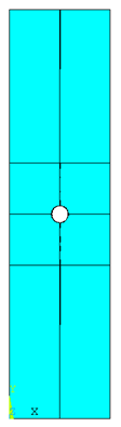

  9. Click Main Menu > Preprocessor > Modeling > Operate > Booleans > Subtract > Volumes.
  10. Select the 8 blocks that were created in Steps 4 and 5 and click OK. When prompted to select the volumes to be subtracted, pick the cylinder and click OK. The plate should appear as shown below.
  11. To complete the geometry, the 8 volumes must be merged. Click Main Menu > Preprocessor > Modeling > Operate > Booleans > Glue > Volumes. Select the 8 volumes and click OK.
    plate geometry
