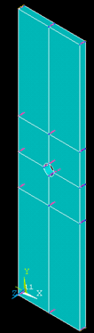

    Since a single element will be used to define the entire 24 ply layup, manual seeds must be specified on the lines parallel to the global Z-direction.
  6. From the top menu, click Select > Everything. Then click Plot > Replot.
  7. Click Preprocessor > Meshing > Size Cntrls > ManualSize > Lines > Picked Lines.
  8. Select all of the lines parallel to the global Z-direction as shown below. Click OK.
  9. In the dialog box that appears, enter a value of 1 in the NDIV entry box. Click OK.
    manual seeding
