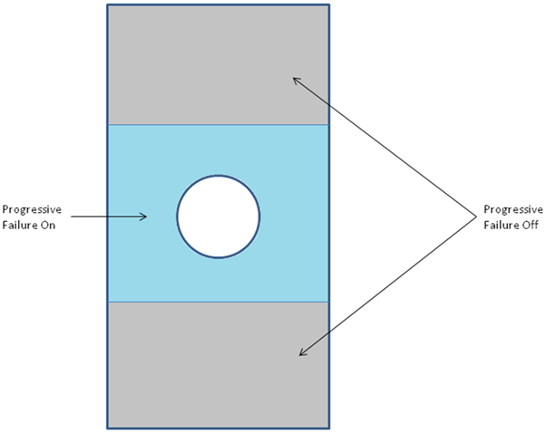

As an example, consider the open hole coupon shown below. Here, we want to deactivate progressive failure in the regions away from the stress concentration, which requires two different materials.
coupon fix
The only way to tell Nastran that different materials are to be used for the two regions is to create two material definitions and assign the materials to the two regions. When used with Helius PFA, each material would have corresponding MATPFA entry as shown below.
MATPFA, 1, 9001, 1, MCT, 0.10, 0.01, INSTANT, OFF
MATPFA, 2, 9002, 1, MCT, 0.10, 0.01, INSTANT, OFF
Note, the only differences in the material definitions above are the material IDs and field 4 on the second line of the MATPFA entry. In general, any coefficient could be changed between the two materials. In a traditional analysis using Helius PFA, two different materials would have to be created and stored in the Materials Database to accommodate the scenario above. This means you would have multiple copies of a single material in the Materials Database, which is not desirable.
For this specific example, the card will appear as:
*MAP, FROM=ID, TO=ID
9002, 9001
In the above, all of the static the material properties from material 9001 will be used for material 9002, while the fields (the dynamic material properties) for 9002 will be used as specified in the input file.
