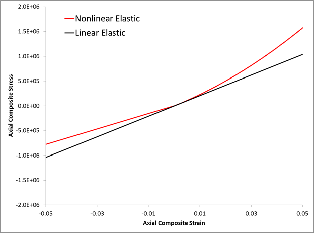

As an example, consider the *NONLINEAR FIBER keyword definition shown below. Given these settings, the material with ID 9002 is assigned a nonlinear fiber parameter of 21.0 and a composite modulus knockdown factor of 0.75. The plot below shows the stress-strain response of this material with the *NONLINEAR FIBER keyword active (nonlinear elastic) and inactive (linear elastic).
*MATERIAL, ID=9002
*NONLINEAR FIBER, ETAC=0.75
21.0
