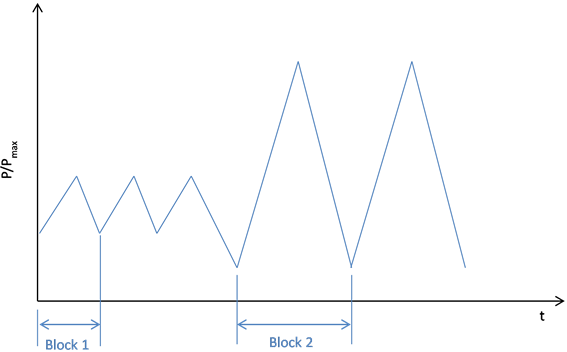

An example load history and the corresponding keywords are given below.
load history
The corresponding keyword would resemble the following:
*FATIGUE, STEP=2
*BLOCK, REPEATS=3
0.1, 0.0
0.3, 0.01
0.1, 0.013
*BLOCK, REPEATS=2
0.05, 0.041
1.0, 0.051
0.05, 0.061
Note: The load history definition is approximated, but each block definition is closed by defining the same load fraction at a greater time stamp. The second *BLOCK command starts at time 0.041 which is after the end of the first *BLOCK command (0.013 * 3 repeats = 0.039).
