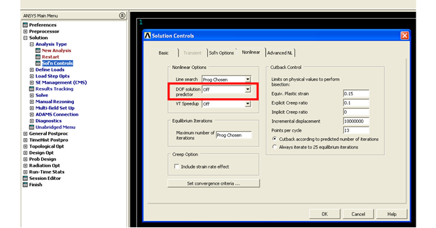

PRED
The PRED command prevents ANSYS from using the converged solution at the last substep to estimate the solution for the current substep. This interferes with Helius PFA's method of managing material linearity. The image below shows how to access this command via the ANSYS Mechanical APDL. As seen below, the "DOF solution predictor" drop-down menu needs to have "Off" selected.

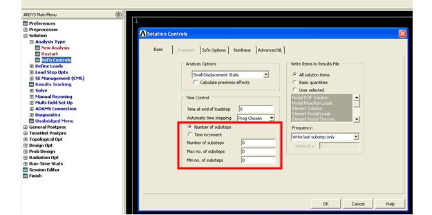

NSUBST
The NSUBST command specifies the minimum and maximum allowable number of substeps for the current load step. Autodesk does not recommend any minimum or maximum values and engineering judgment should be exercised. However, provided that enough equilibrium iterations are allowed per substep (discussed under NEQIT heading), Helius PFA will always find a converged solution. This is a deviation from typical nonlinear solution processes where multiple substep size cutbacks may be required. Helius PFA will converge at each substep, regardless of the size (again provided that enough equilibrium iterations are allowed per substep), so care must be taken when deciding on substep size. The image below displays where to specify the number of substeps in the ANSYS Mechanical APDL.

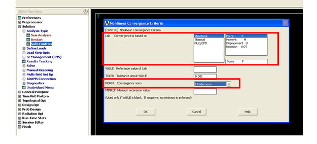

CVNTOL
The CNVTOL command is used to define the convergence tolerance for residual node forces. There are two arguments set in this command that allow Helius PFA to better handle the nonlinear solution process: a) set forces (F) as the convergence label, and b) set the norm selection to infinite norm (check each DOF separately). The image below displays where to set these arguments in the ANSYS Mechanical APDL.

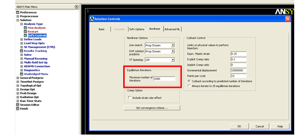

NEQIT
The NEQIT command is used to specify the minimum number of equilibrium iterations that must be performed before ANSYS evaluates the need for cutting-back the size of the current substep. Helius PFA has the unique ability to converge regardless of the substep size or extent of nonlinearity occurring during the substep. In the experience of Autodesk, convergence always occurs when the number of equilibrium iterations allowed per substep, before a substep cutback occurs, is set to 1000. The image below displays how to set this argument via the ANSYS Mechanical APDL.
