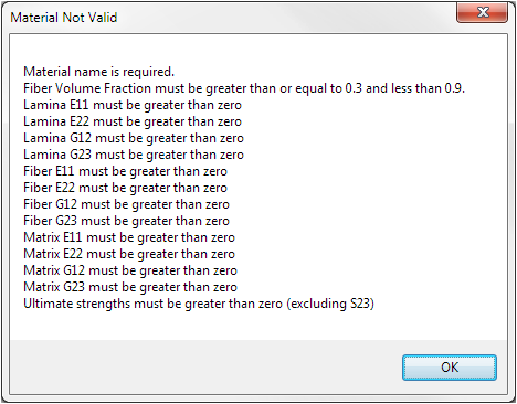

When File > Save As is selected, a check is performed to ensure the required data has been entered and is within appropriate limits. An error message will result if data is entered incorrectly. An example error message is shown below.
not valid
