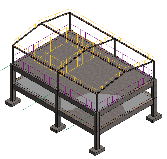

Create a model in Autodesk Revit Structure or Autodesk Revit Architecture.

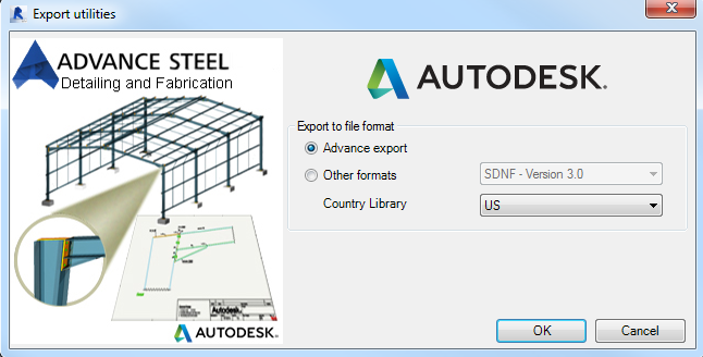

  1. Access the Export command:
  2. Select the appropriate export option:
    • Advance export - exports the model as a SMLX format, used for import in Advance Steel.
    • Other formats - option to select from SNDF 2.0, SDNF 3.0, CIS2, IFC and PSS formats.
    • Country Library - filters the automatic section mapping to a specific country library.
  3. Click OK.

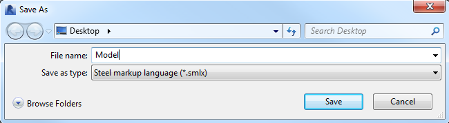

  4. In the Save As dialog box select the location where you want to save the exported file.

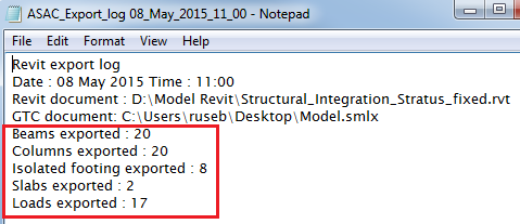

A log file is created automatically and stored in a Temp folder, for example "C:\Users\Name\AppData\Local\Temp".
The report contains information about the number of exported elements and lists the elements that cannot be exported.

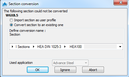

  2. If one of the steel/concrete column or beam sections created in Revit has no corresponding section in Advance Steel, a dialog box appears where a corresponding section can be selected.

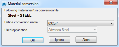

  3. Also when the material does not exist in Advance Steel it may be necessary to select a suitable material for the conversion.

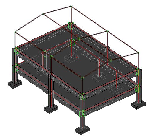

The imported model:
