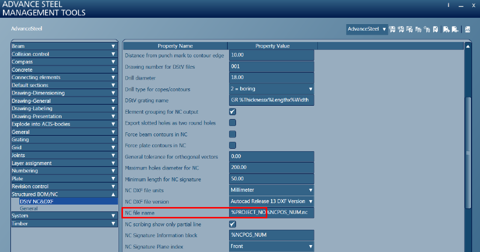

  2. Select Defaults and then use the filter and type NC. A shortened listing will be available. Look for the following reference: NC file Name.

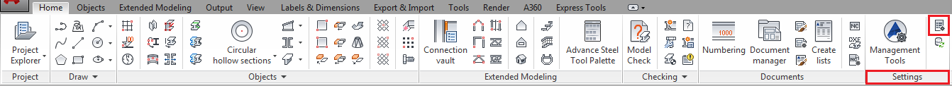

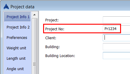

  3. Select that Option and you will see the dialog change to show the Value currently available. The current default is set just to show the part number of the component, either the single or Main part depending on the NC settings options set within Advance Steel ( files can run for either single or main parts). It is possible to add additional tokens to this Value and in this instance we can add "%PROJECT_NO". This corresponds to the Project number set in the Project settings button under the Advance Steel tools ribbon tab, Settings panel.
    Accessing Project Settings:

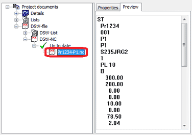

  5. After this, if you run NC Files using the NC option under AS documents, NC & DXF panel, the files should be created and should appear in the Document manager.
    Note: You should now have the project number at the front of the file name.
With this change to the settings from Management Tools the NC file should now have a distinct reference to the project and can be easily identified.

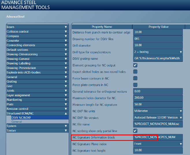

  1. Start the Management Tools.
  2. Use the filter with the NC. When this has been run you should see one that refers to "NC Signature Information block".
  3. Select it.

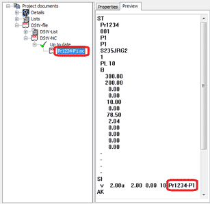

  4. You can add in the Project Number, this will then become part of the text within the Hard Stamping then placed upon the component.
  5. After this change is applied you can run the NC files and you will see that the project number is now included under the line in the NC File that controls the Stamping text input .
So when the component is produced, this reference will appear on the Face of the object and will also help identify the component by project reference as well as by its component number.

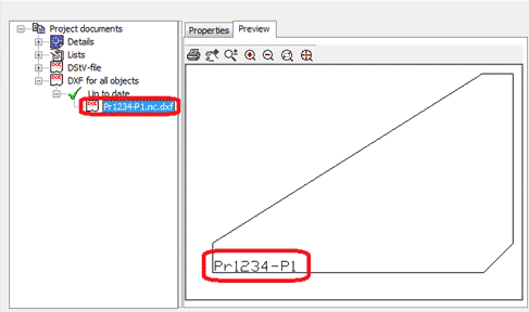

This will also apply to DXF files created from the model:
