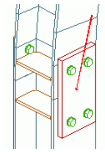

To add objects to marking:
  1. Select the objects to be highlighted using one of the selection methods.
  2. Selection tool palette: Click (Add selected objects to marking).
The selected objects are highlighted in red in the model.

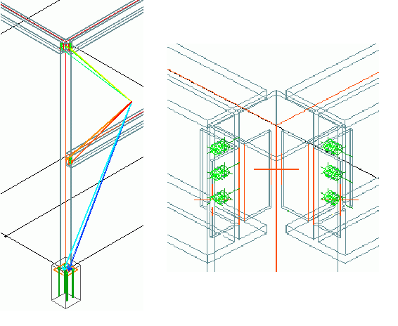

Search Marked Objects
Within a large model, highlighted objects are not always easy to find. For example, clashes are usually small, therefore it is often very hard to find the collision solids in the model without help.
The objects can be displayed with an arrow starting from the center of the viewport for easy identification. The arrow can be deleted or hidden, just like any other object.
Note: With the Search marked objects tool () you can zoom directly to an area in the arrowhead.

Zoom to Marked Objects
Using the Zoom to marked objects tool, the objects can be displayed with an arrow starting from the center of the viewport for easy identification. After finding the highlighted objects, this tool allows viewing the area in the arrowhead.
To access the command:
Selection tool palette: (Zoom to marked objects).
Command line: _AstM4CommGotoMark
To zoom to a marked object
  1. Selection tool palette: Click (Zoom to marked objects).
  2. Select one of the displayed arrows and press Enter.
  • The area where the highlighted element is placed is displayed.
