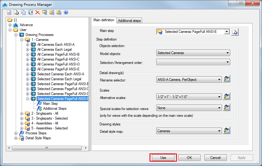

  3. Open the Drawing Process Manager in the Output tab > Document Manager panel.

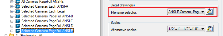

  4. Click the button, next to the Filename selector drop-down.

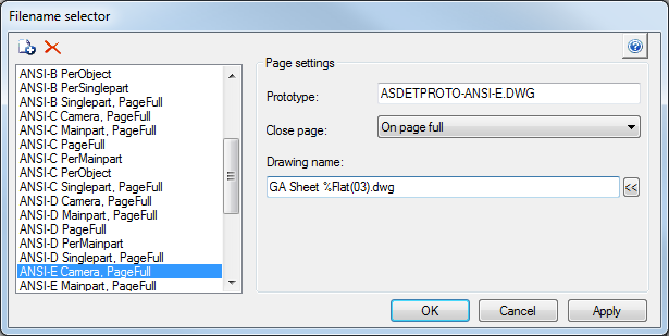

  5. In the Filename selector dialog, you can see the used prototype and the Drawing name.
  6. Close the dialog.
  7. Click Use in the Drawing Process Manager window.

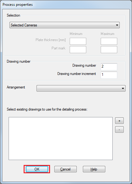

  8. Click OK in the Process properties window.

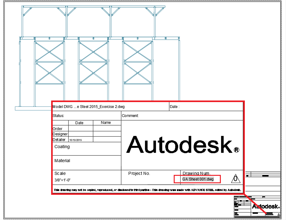

  9. Open the created detail drawing and see the result.
