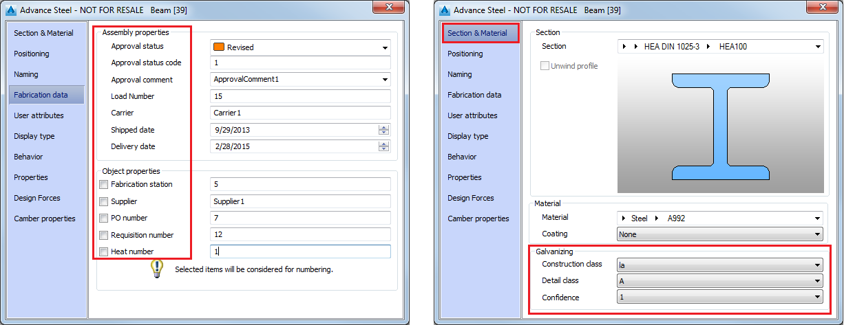

Object fabrication data parameters can be included in:
  1. Templates for external Bills of Material:
    • In object lists (MainPart, Single part, etc.):

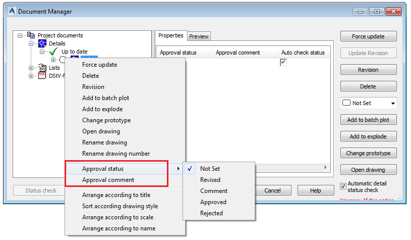

    • Drawing approval statuses and drawing approval comments can be used in drawings lists:
  2. Templates for Bills of Material that are placed on drawings.
  3. In prototype headers.
    List of available attributes for prototype headers:
    APPROVAL_STATUS_ASSEMBLY Approval Status
    APPROVAL_STATUS_CODE_ASSEMBLY Approval Status Code
    APPROVAL_COMMENT_ASSEMBLY Approval Comment
    CARRIER Carrier
    LOAD_NUMBER Load Number
    SHIPPED_DATE Shipped Date
    DELIVERY_DATE Delivery Date
    GALVANIZING_CONSTRUCTION_CLASS Construction Class
    GALVANIZING_DETAIL_CLASS Detail Class
    GALVANIZING_CONFIDENCE Confidence
    FABRICATION_STATION Fabrication Station
    SUPPLIER Supplier
    PONUMBER Po Number
    REQUISITION_NUMBER Req Number
    HEAT_NUMBER Heat Number
