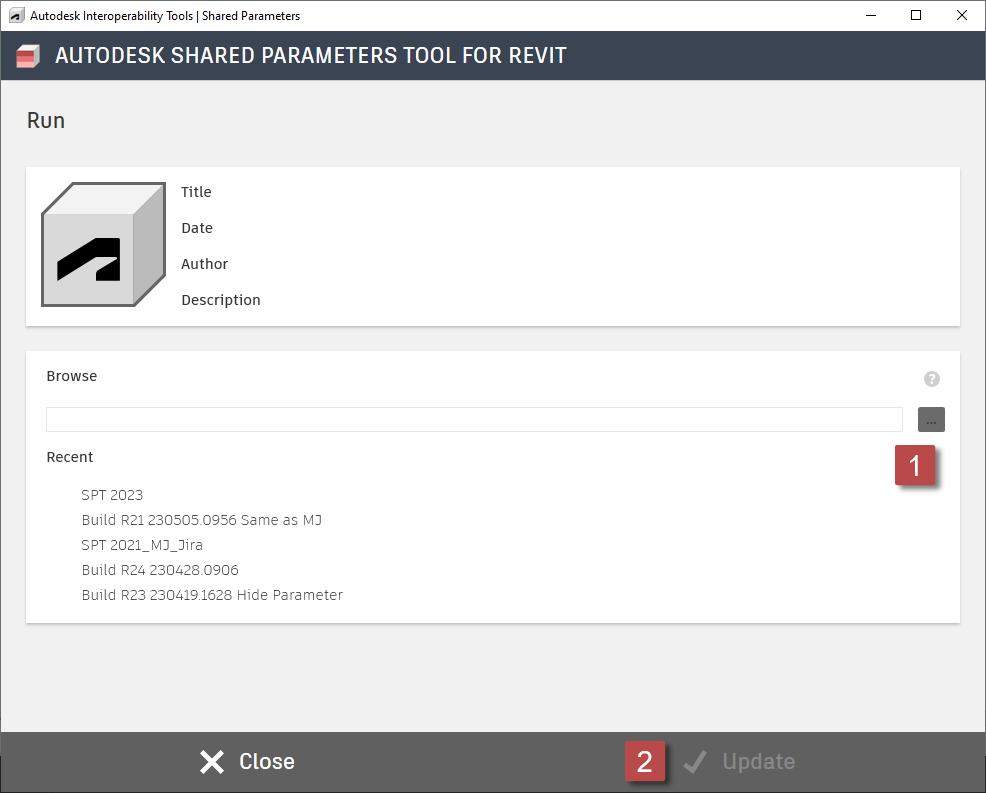

The Shared Parameter Tool for Revit from Autodesk will allow you to quickly apply shared parameters consistenly to all your Revit files. The Run tool will add the shared parameters to the current file based on the selected configuration file.
Shared Parameter Ribbon image
Using the Run tool will open a single dialog box for selecting a configuration file. If you do not have a configuration file, use the Setup tool to create one.
Run Step 1
  1. Use the "..." button to navigate to a configuration file, or select one from under Recent.
  2. Click update to add the parameters to the current Revit File.
