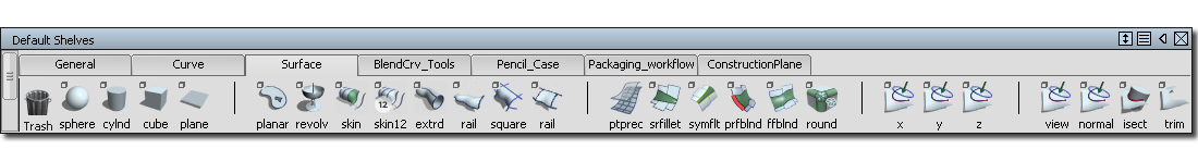

- Middle mouse button to drag a tool from the Palette or the Menu onto the shelf.
- Middle mouse button to drag a tool into the Trash, or to reposition it on the shelf.
- Use CTRL double-click to rename a shelf tab, or a tool. This is important if you have multiple versions of one tool with different settings.
- Use ALT double-click to save an image of the tool icon that you can repaint to create your own icon. (Rarely used)
- Use Preferences > Interface > Palette/Shelves Layout to fix a location for the shelves.
- Use Preferences > Interface > Shelf Extras to help design the shelf layout. Use the middle mouse button to drag 'spacers' onto the shelf:

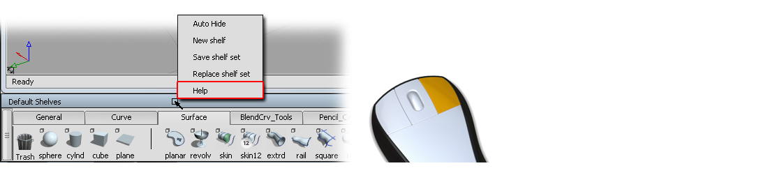

For more information, access the Help for the shelves using the right mouse button on the shelf title bar.

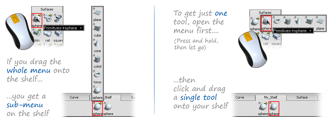

Note: Single-Tools and Sub-Menus
Be careful to choose either a whole menu, or just a single tool when dragging tools onto the shelves.

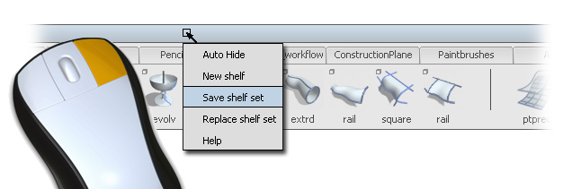

- Right-click on the Shelf title bar to Save the shelf set and name it.

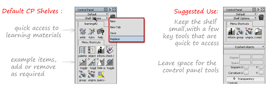

Control Panel Shelf
The Control Panel shelf works exactly the same as the main shelf, it just offers a second, smaller area for customization.
The shelf is specific to the four Application Modes, and will change when the modes are changed.
