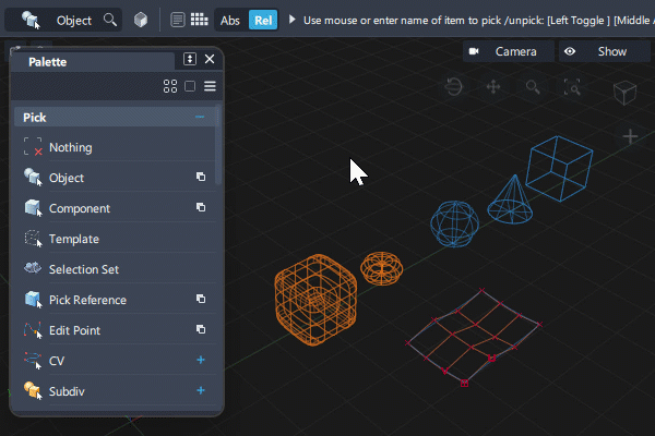

Pick Nothing
Use Pick Nothing to ensure that no objects in the scene are selected, for example:
- Use Pick Nothing after other Pick tools have been used to deselect everything.
- Use Pick Nothing before using a modelling or editing tool. This ensures that there are no objects out of view accidentally selected, in which they would be inadvertently affected by the tool.
- Use Pick Nothing as a shortcut for Next in the tool workflow.
Access the tool from the Pick Palette or from the default LMB Marking Menu:

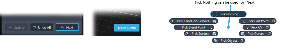

Pick Nothing used for Next function in tools
In many tools, there is a Next button in the Control Window that ends one operation of the tool and begins the next (or a button in the model window).
Pick Nothing has the same effect as the Next button.
