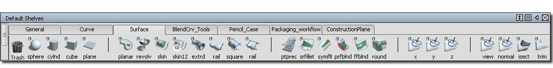

Tools for Working with Shelves
The following are the main tools and techniques for creating your own shelves:

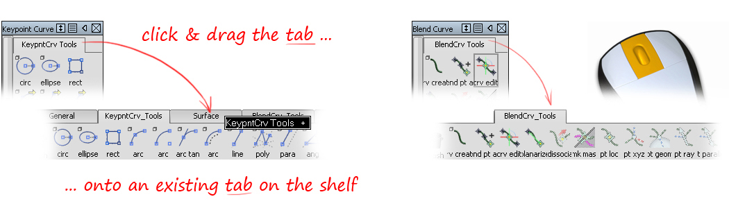

Middle mouse button to drag a tool from the Palette or the Menu onto the shelf.
Middle mouse button to drag a tool into the Trash, or to reposition it on the shelf.
Use CTRL double-click to rename a shelf tab, or a tool. This is important if you have multiple versions of one tool with different settings.
Use ALT double-click to save an image of the tool icon that you can repaint to create your own icon. (Rarely used)
Use Preferences > Interface > Palette/Shelves Layout to fix a location for the shelves.

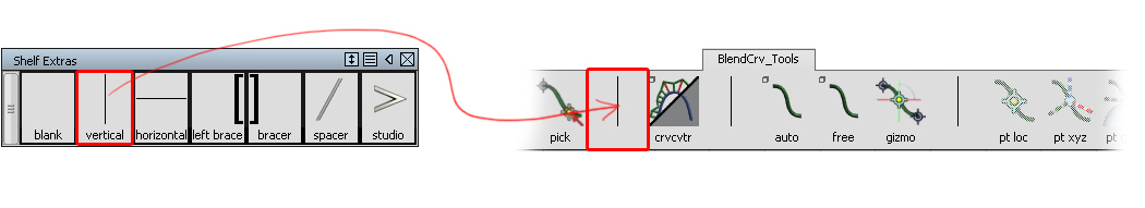

Use Preferences > Interface > Shelf Extras to help design the shelf layout. Use the middle mouse button to drag 'spacers' onto the shelf:

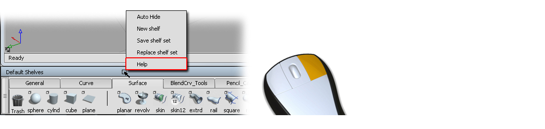

For more information, access the Help for the shelves using the right mouse button on the shelf title bar.

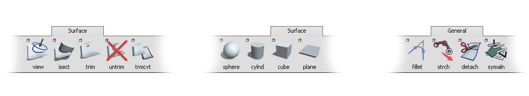

There are three main reasons for adding tools to a shelf:

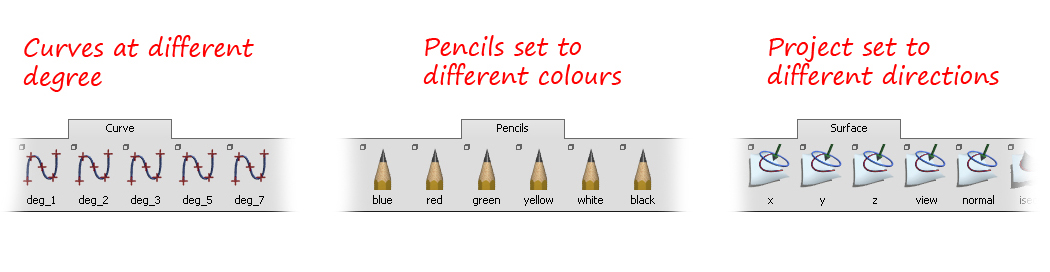

The same tools with different settings...
Opening out a whole toolbox along a shelf...
Avoiding pull-down menus for tools that you use often. For example – trim and untrim.

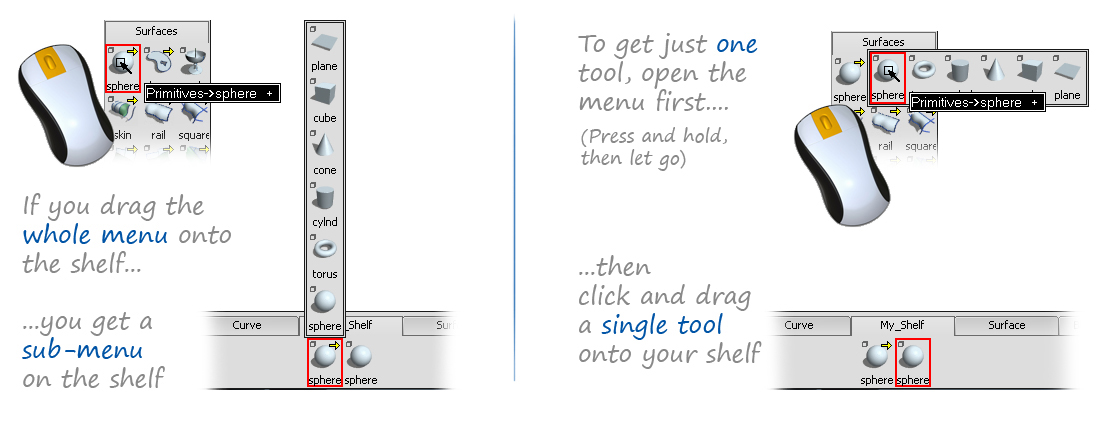

Note: Single-Tools and Sub-Menus
Be careful to choose either a whole menu, or just a single tool when dragging tools onto the shelves.

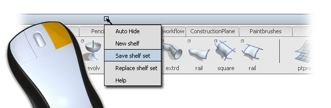

Saving Shelves
Once you have added tools and tabs to the shelves, you must save them:
To save the shelf as the default shelf, AND all other changes to the interface:
- Right-click on the Shelf title bar to Save the shelf set and name it.
- Use Preferences > User Preferences > Save.
To save only the changes to the shelf as the new default shelf
- Use Utilities > Tool Resets to return all other changes to their saved or default settings. Be careful NOTto reset the shelves.
OR...
- Exit Alias without saving preferences.
- Start Alias, and load your saved shelf set into the shelves (use Replace Shelf Set from the shelf menu)
- Use Preferences > User Preferences > Save straight away.

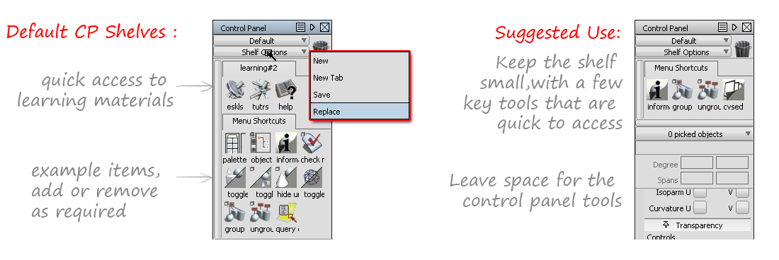

Control Panel Shelf
The Control Panel shelf works exactly the same as the main shelf, it just offers a second, smaller area for customization.
The shelf is specific to the four Application Modes, and will change when the modes are changed.
