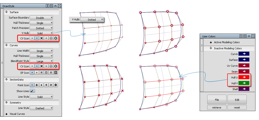

Choosing the Control Point Style
- Object Display > Draw Style
- Preferences > Interface > User Colors

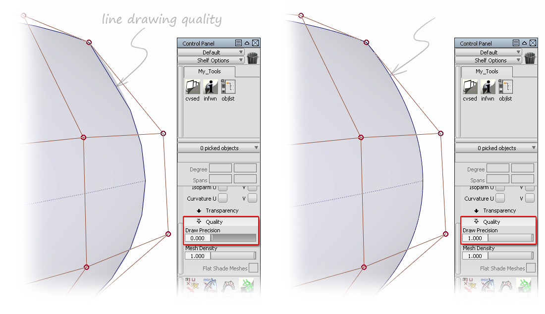

Drawing quality
- Control Panel > Display > Quality > Draw Precision
