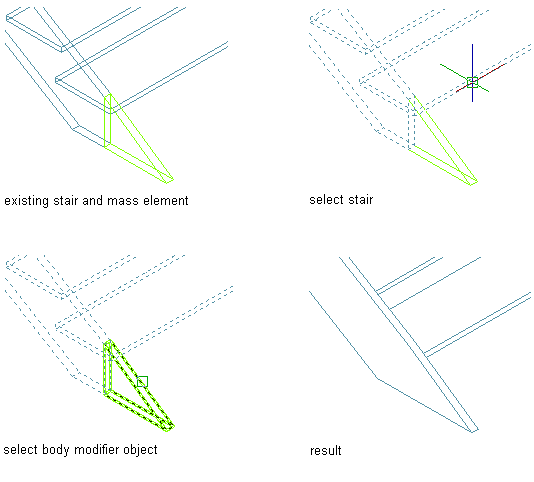

You can create a three-dimensional (3D) body modifier from a mass element, a mass group, or any other AEC object with mass. You can also create body modifiers from ACIS solids or blocks that form 3D bodies. You must place the object in the location you want in the drawing before defining the object as a body modifier.
The following illustration shows you how to use a mass element as a body modifier to add to a stair stringer component.
Adding a body modifier to a stair component
  1. Place the object in the location where you want to add the body modifier to the stair.
  2. Select the stair you want to change with the body modifier, and click Stair tabModify panelBody Modifier drop-downAdd.
  3. Select the object to add to the stair component.

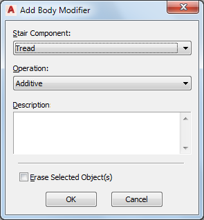

  4. In the Add Body Modifier dialog box, select Stringer for Stair Component and Additive for Operation.
  5. Enter a description for the body modifier.
  6. Select Erase Selected Object(s) if you do not want to keep the original object, or clear this option to keep the object in the drawing.
  7. Click OK.
