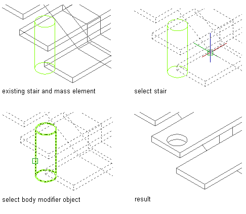

The following illustration shows you how to use a mass element as a body modifier to subtract from a stair tread component.
Subtracting a body modifier from a stair component
  1. Place the object in the location where you want to subtract the body modifier from the stair.
  2. Select the stair you want to change with the body modifier, and click Stair tabModify panelBody Modifier drop-downAdd.
  3. Select the object to subtract from the stair.

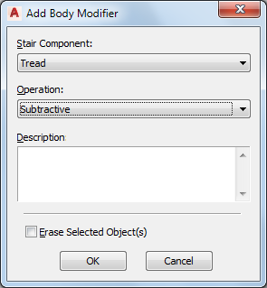

  4. In the Add Body Modifier dialog box, select Tread for Stair Component and Subtractive for Operation.
  5. Enter a description for the body modifier.
  6. Select Erase Selected Object(s) if you do not want to keep the original object, or clear this option to keep the object in the drawing.
  7. Click OK.
