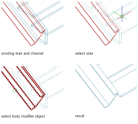

The following illustration shows you how to use a channel as a body modifier to replace a stair stringer component.
Replacing a stair component with a body modifier
  1. Place the object in the location where you want to replace the stair component with the body modifier.
  2. Select the stair you want to change with the body modifier, and click Stair tabModify panelBody Modifier drop-downAdd.
  3. Select the object to replace the stair component.

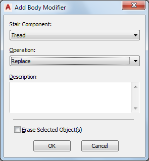

  4. In the Add Body Modifier dialog box, select Stringer for Stair Component and Replace for Operation.
  5. Enter a description for the body modifier.
  6. Select Erase Selected Object(s) if you do not want to keep the original object, or clear this option to keep the object in the drawing.
  7. Click OK.
