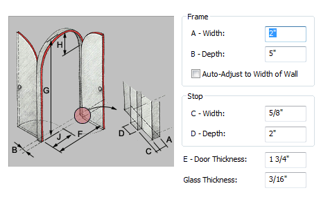

Use this procedure to change the default dimensions of a door style.
  1. Click Manage tabStyle & Display panelStyle Manager.
  2. Expand Architectural Objects Door Styles.
    Note: Alternatively, you can select a door, and click Door tabGeneral panelEdit Style drop-downDoor Styles.
  3. Select the style you want to edit and click the Dimensions tab.
    Changing door style dimensions
  4. Change dimension values:
    If you want to… Then…
    change the frame width and depth under Frame, enter values for Width and Depth.
    set the frame width to the wall thickness under Frame, select Auto-Adjust to Width of Wall.
    change the stop dimensions under Stop, enter values for Width and Depth.
    change the door thickness enter a value for Door Thickness.
    change the glass thickness enter a value for Glass Thickness.
  5. Click OK.
