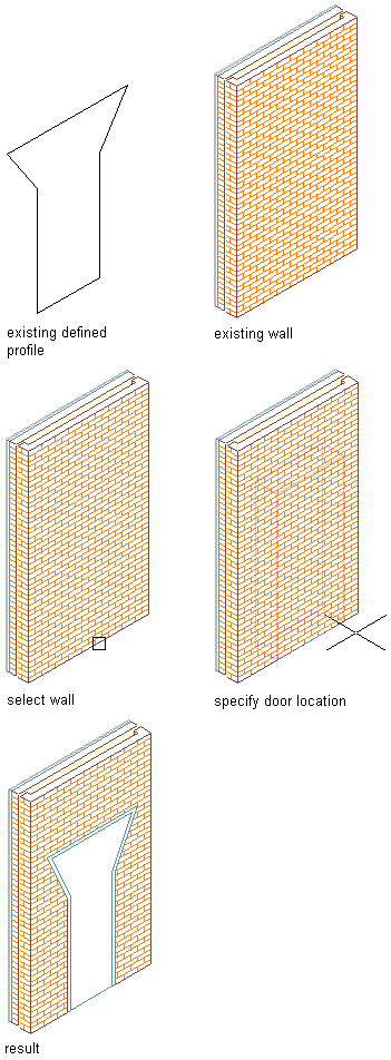

Use this procedure to replace a predefined shape in a door style with a custom shape created from a profile.
  1. Select a door that uses the style you want to modify.
  2. Click Door tabProfile panelAdd Profile.
  3. Specify the profile to use for the custom shape:
    If you want to… Then…
    use a predefined door shape select a profile for Profile Definition, and click OK.
    use a predefined door shape, but modify it select a profile for Profile Definition, select Continue Editing, and click OK.
    create a custom shape select Start from scratch for Profile Definition, enter a name for the new profile, and click OK.
