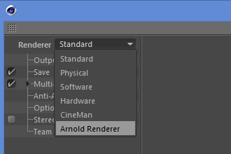

  2. Go to the render settings and select Arnold Renderer.

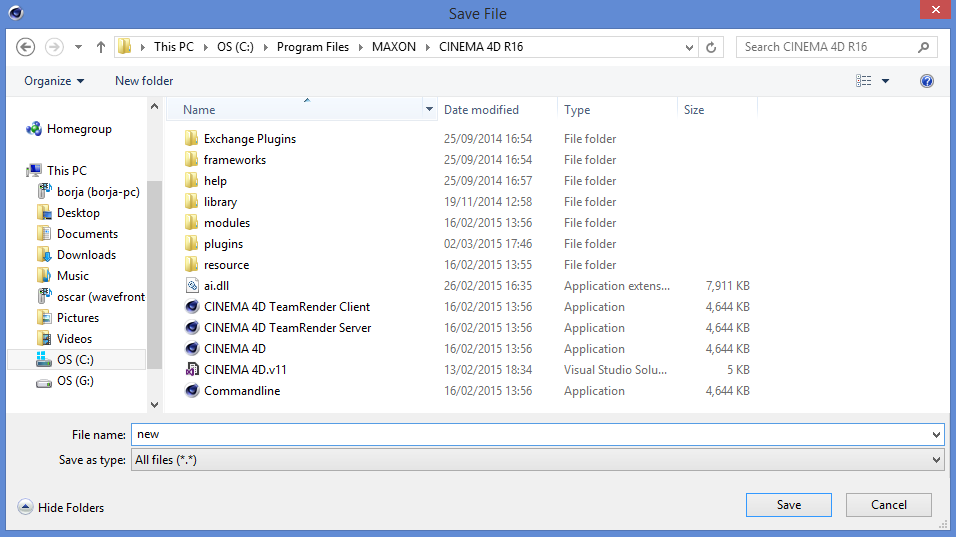

  4. Save your scene to the C4D install folder (where the Cinema 4D executable is located [c:\Program Files\Maxon Cinema 4D R25 on Windows, /Applications/Maxon Cinema 4D R25 on macOS]) using the name new.c4d.
