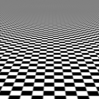

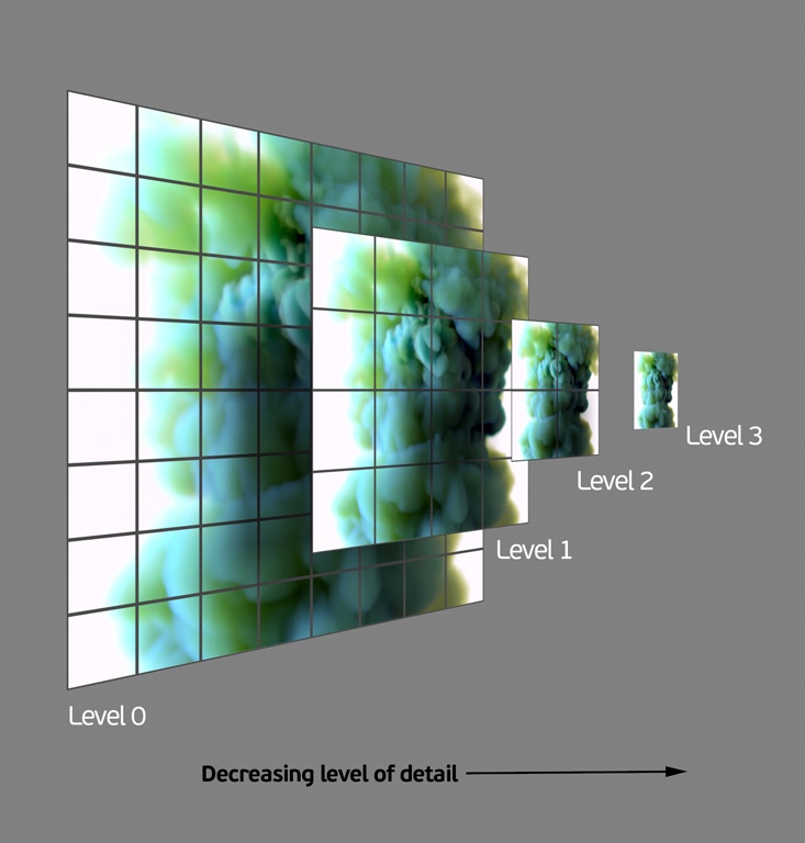

Mip-Mapping Bias offsets the Mip-Map level from which a texture is sampled. Negative values indicate a larger Mip-Map level (bigger texture); a positive value indicates a smaller Mip-Map level (smaller texture). This is evident at the top of the images below:
Diagram showing Mip-Mapping process

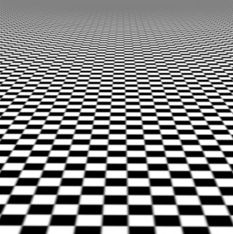

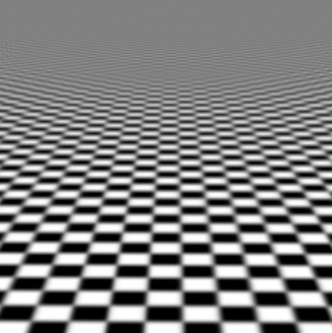

The example below shows the effect on a render when increasing the Mip-Mapping bias:
Mipmap Bias 0 Mipmap Bias 1 Mipmap Bias 2
