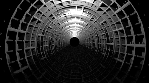

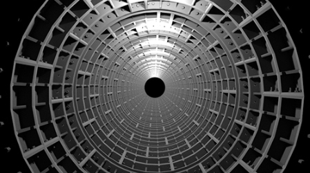

| without Global Light Sampling | with Global Light Sampling (2x faster render time) |
In Arnold 7.2.1, we introduced the Global Light Sampling method, which analyzes the lights in the scene and automatically decides how best to distribute a globally specified number of light samples among all the lights in the scene. Unlike the older per-light sampling method, which required setting a light samples value for every light, Global Light Sampling just requires setting this one value, making it easier to use and tune. What's more, it allows for the global number of light samples to be less than the total number of lights, and therefore, it produces significantly faster renders when there are many lights.

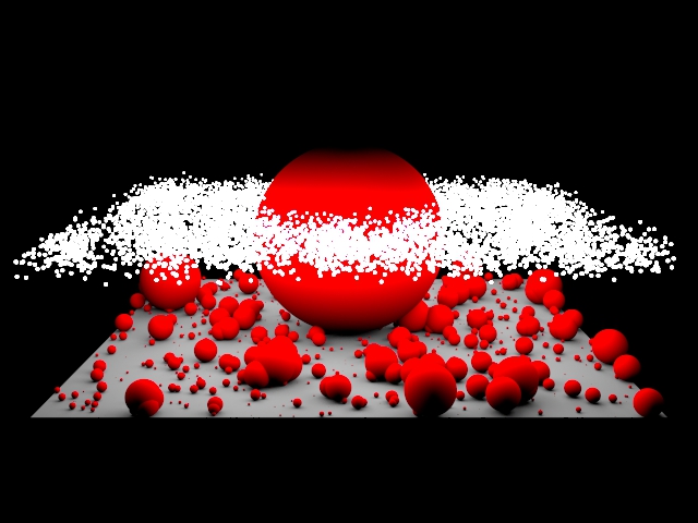

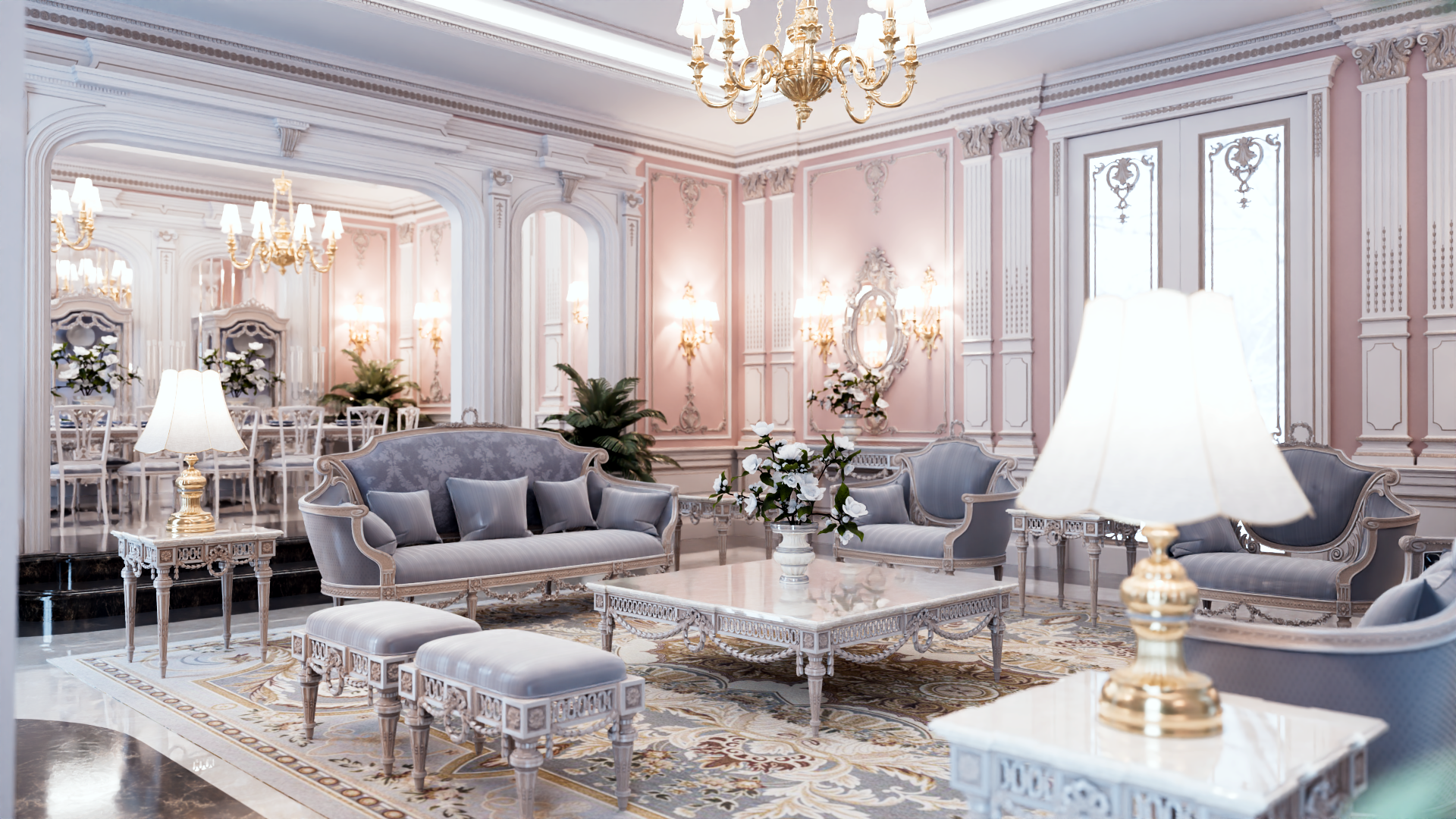

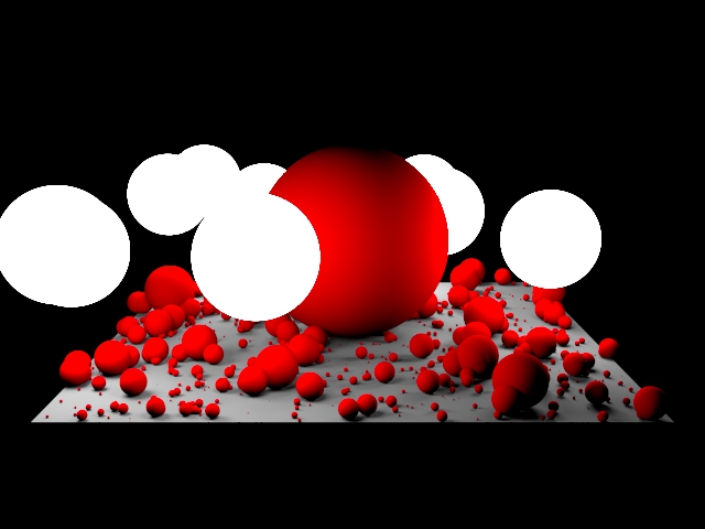

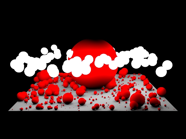

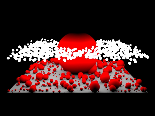

Here is an example of the improved render times when using Global Light Sampling. This scene has light counts ranging from 10 to 100,000 and is rendered with adaptive sampling (AA=4, AA_max=20) in order to run until it achieves the same noise level image in each case:
| 10 lights | 100 lights | 1000 lights | 10000 lights |
The render times for per-light sampling and Global Light Sampling, here with one sample per light, and Light Samples = 2 for Global Light Sampling, are as below:
We can see both techniques perform similarly for low light count. However, the render time for per-light sampling scales roughly linearly in the number of lights, while with Global Light Sampling, the render time grows with light count at a much reduced rate. At 10k lights, the Global Light Sampling technique is over 100 times faster.

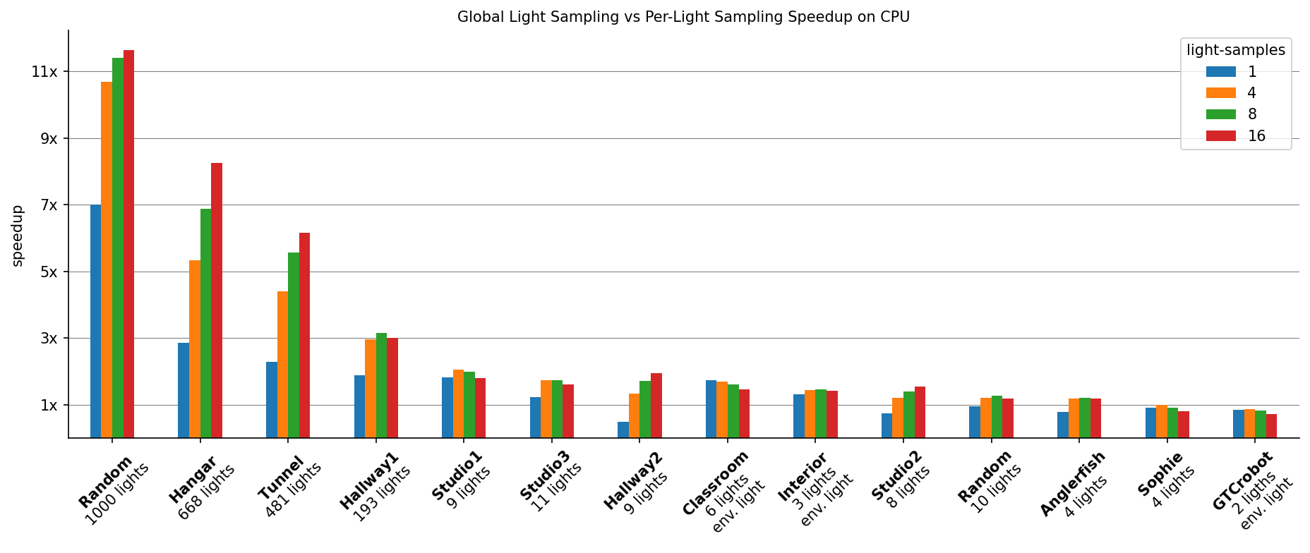

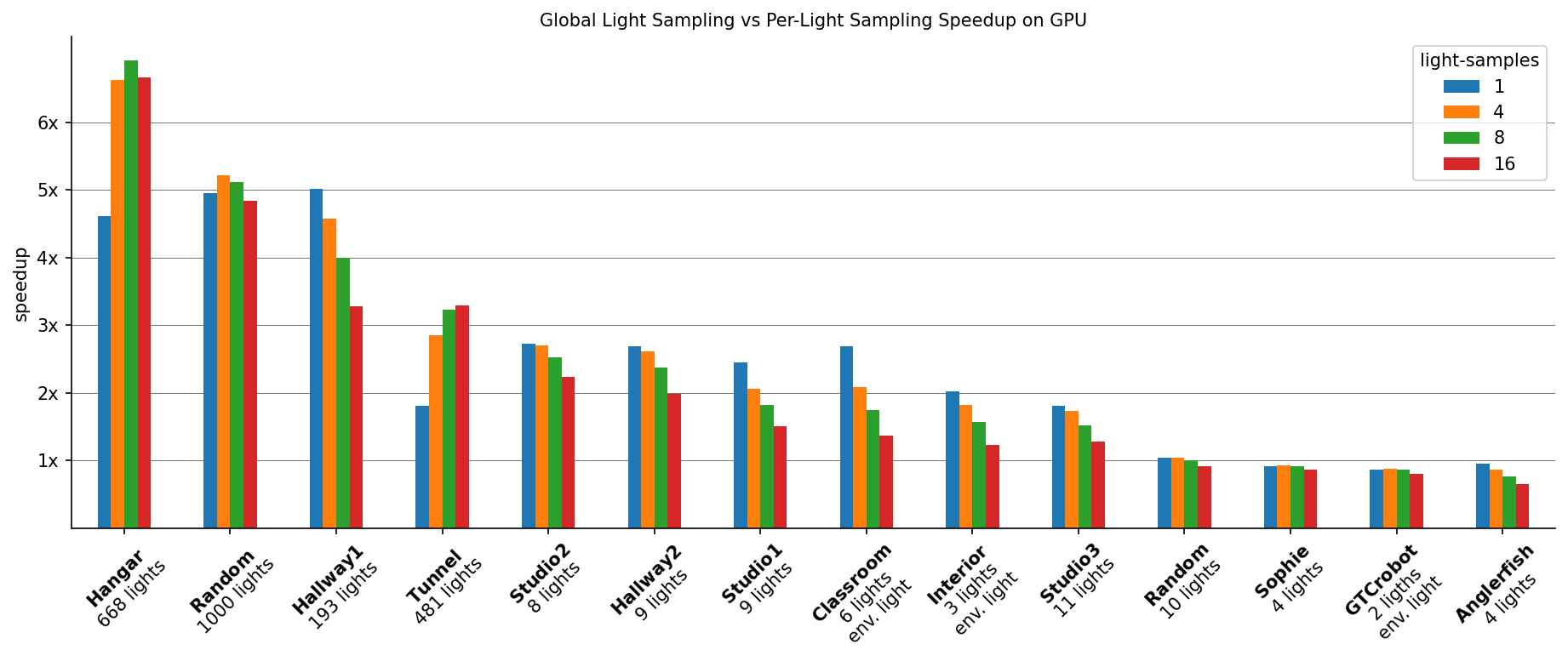

When using the Global Light Sampling method on CPU, we recommend keeping Light Samples at 4 or fewer. On GPU, we recommend keeping Light Samples at 1. Generally, if the main source of light is from a Skydome Light or Distant Light, 1 or sometimes even no global light samples work best; otherwise, 4 for CPU and 1 for GPU tends to be near optimal. Very rarely do more samples significantly help, even if there are many lights.
With Global Light Sampling, the number of light samples affects noise and render times. The charts below show the speedups on CPU (relative to per-light sampling) for global light samples from 1 to 16. For most scenes, a value of 4 (the default in most Arnold plugins) gives a good speedup, and you can increase the Camera (AA) to deal with any noise.
For GPU, the situation differs slightly. In the bar plot below, we show speedups (relative to per-light sampling) in different scenes for 1, 4, 8, and 16 light samples. Unlike with CPU, for GPU, using 1 light sample is often enough (except for Hangar and Tunnel scenes).

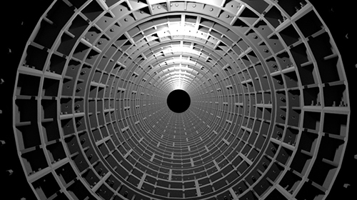

In the example below, increasing the Low Light Threshold to 0.1 shows a good speedup in render time (in this case, more than twice as fast) with little noticeable difference in the image.
| Low light threshold: 0.01 | Low light threshold: 0.1 |
A slightly higher threshold can offer significant rendering speed increases without noticeably darkening the image.

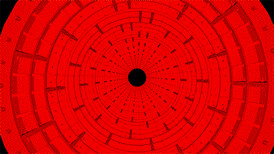

| Low light threshold: 1 |
The Utility shader's nlights color mode can be used to see how many lights are influencing a shading point when adjusting the Low Light Threshold.
