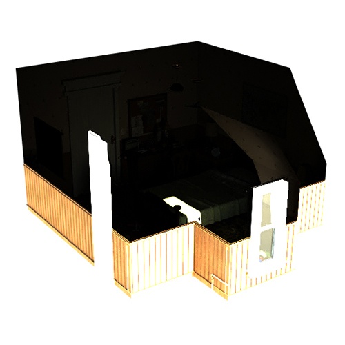

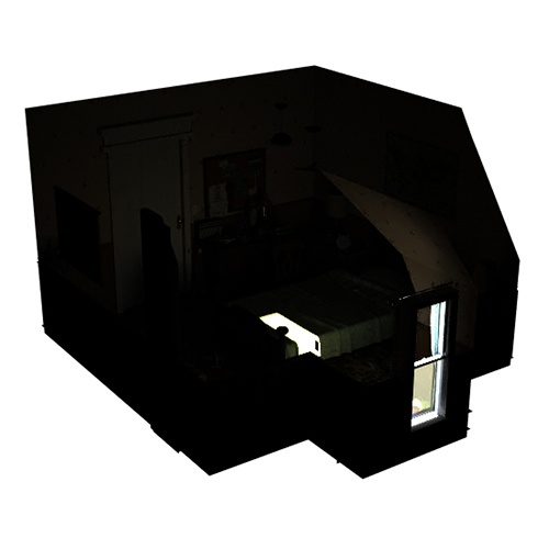

Portal Mode
Defines how the skydome light interacts with light portals.
  • Off: turns off portals.
  • Interior Only: blocks any light outside portals for interior-only scenes.
  • Interior Exterior: lets light outside portals through for mixed interior and exterior scenes.
Blocking light outside portals more predictably reduces noise for interior-only scenes.
