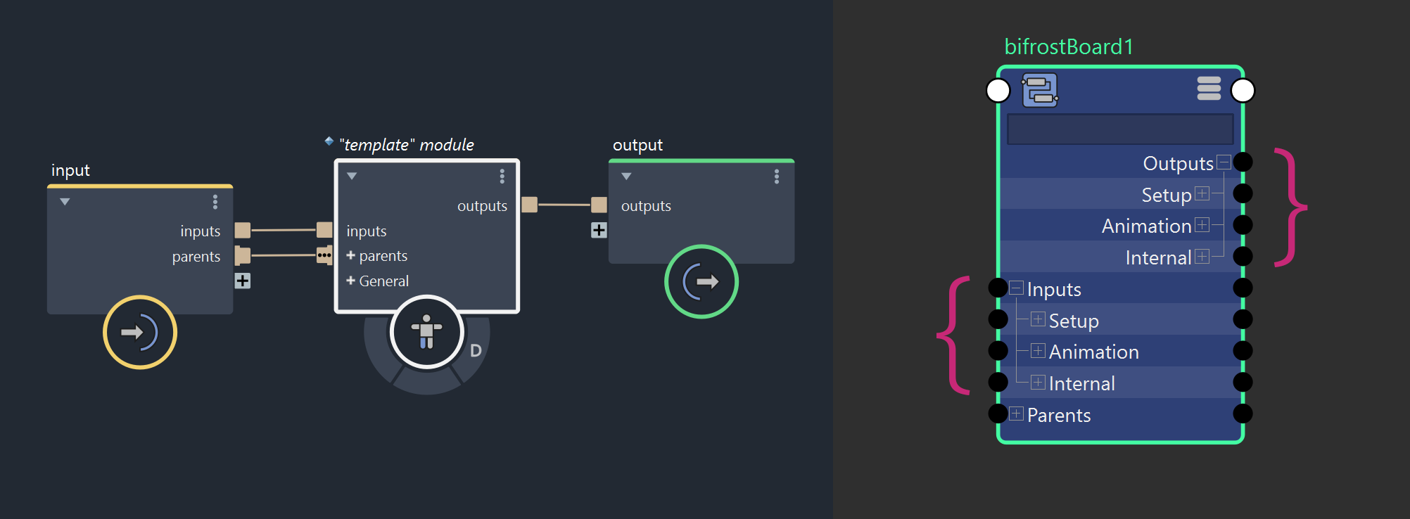

Accessing Module Data From Maya
You can expose the inputs, outputs, and parents ports of a rigging module at the top level of the Bifrost graph. Once exposed, these ports become accessible in Maya as compound attributes.
Each compound attribute mirrors the structure of their respective rigging module types, making it easy to navigate and interact with. You can query values, set values, or connected to the nested attributes by hand or scripting, just like with any standard Maya node.
This enables seamless interaction between Bifrost modules and Maya, allowing you to access module data to generate Maya objects and attributes, and drive modules directly from them.

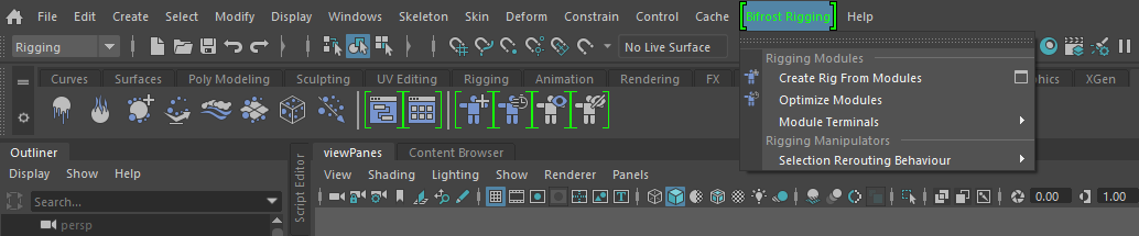

Rigging Menu and Shelf Tools
Tools for working with Bifrost rigging modules can be accessed from the Bifrost Rigging menu when Maya's menu set is set to Rigging. The same tools are also available as shelf buttons in the Bifrost shelf tab.
These tools operate on all Bifrost graphs in the scene if nothing is selected. If one or more graphs are selected, the tools apply only to the selected graphs. Both bifrostGraphShape and bifrostBoard node types are supported.
The available tools include:
Create Rig From Modules: Creates a Maya rig from exposed rigging modules. Rig creation options can be adjusted through the Option Box.
Optimize Modules: Sets modules into a high-performance state by disabling the
edit_modeandprofile_evaluationparameters.Module Terminals: Enables or disables the modules' terminal D flags.
Selection Rerouting Behaviour: Toggles the
optionVarthat defines automatic selection behavior when working with Bifrost Rigging Manipulators. This applies only to rigs created using thecycleFreesetup method.

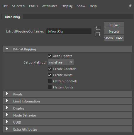

Working with a Synced Container
When generating a rig, you have the option to create it within a synced container. A synced container monitors changes made to modules within connected Bifrost graphs and automatically deletes and rebuilds the rig whenever a module's setup is recomputed.
This is especially useful during rig development, as it allow you to freely modify the rig structure, such as adding or removing modules, changing control shapes, adjusting parenting relationships, or altering the number of joints and controls.
All changes are applied in real time without requiring you to manually recreate the rig. However, synced containers should be used with care and are generally recommended only during rig development.
A synced container also lets you adjust rig creation settings directly from the Attribute Editor. Any changes to these attributes will trigger a full rig reconstruction.
The autoUpdate attribute controls whether automatic updates are performed. It is enabled by default when the rig is first created but will automatically be disabled when the scene is reopened, as a safety precaution. By extension, a synced container does not perform automatic updates when loaded as a reference.
Keep in mind that synced containers will remove and recreate all rig objects on update. Any manual edits to objects or extra connections will be lost upon rig reconstruction.

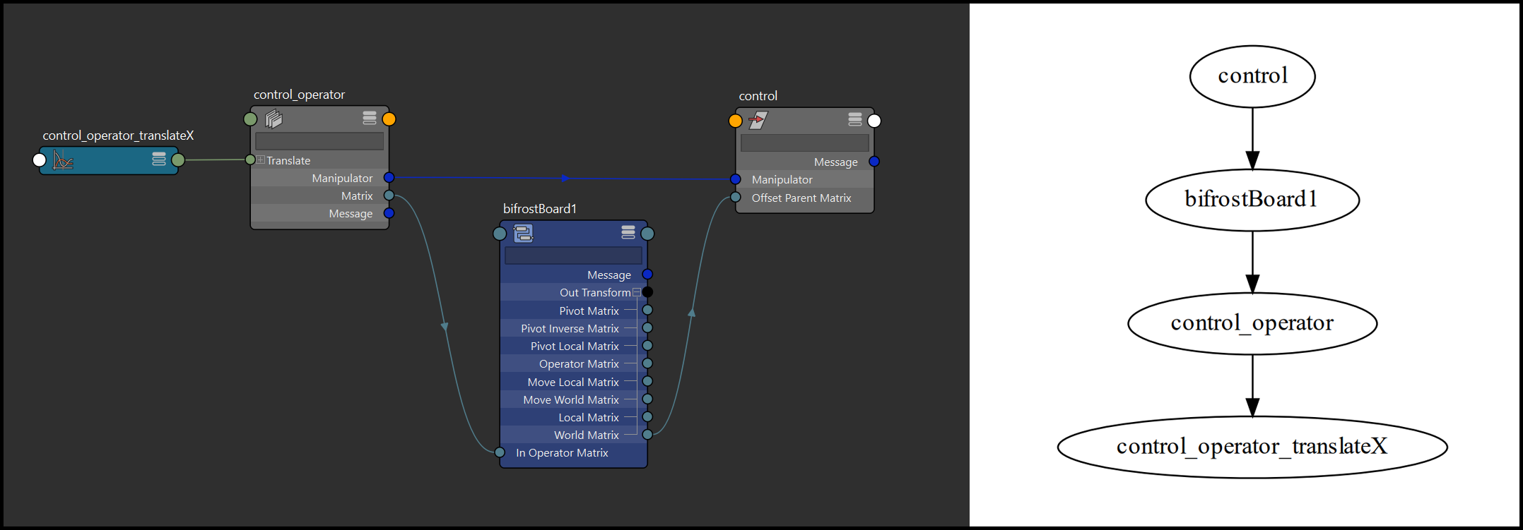

cycleFree
The cycleFree mode completely eliminates cyclic dependencies in the Maya scene, ensuring predictable evaluation and improved runtime performance. However, it disrupts the interaction behavior in Maya.
In this mode, each Bifrost transform generates two Maya nodes: an operator object that feeds its matrix into the graph as input, and a primary object (control or joint) that is driven by the graph's output.
- The primary object (control or joint) is visible in the viewport and reflects the final evaluated transform, but it is not directly manipulatable. It primarily serves for visualization and selection.
- The operator object is invisible in the viewport but is manipulatable and keyframable. It drives the Bifrost graph and the corresponding primary object.
Because the selectable object (primary) and the manipulatable object (operator) are different, cycleFree relies on two mechanisms to ensure intuitive interaction:
- Selection Rerouting: When a primary object is selected, Maya automatically reroutes the selection to the corresponding operator, depending on the rerouting mode. This ensures that manipulation and keyframing always operate on the correct underlying node.

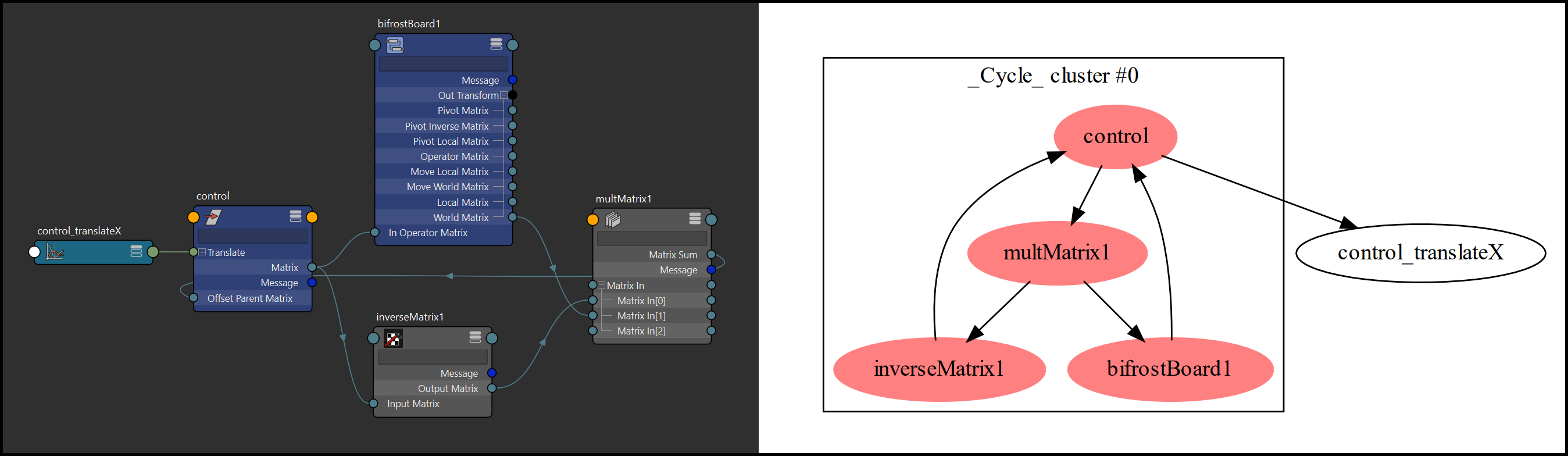

native
In native mode, for each Bifrost transform, a single Maya object is created (either a control or a joint) that drives the Bifrost graph while being simultaneously driven by it.
This approach preserves Maya's standard interaction behavior:
- The transform node is visible, selectable, manipulatable, and keyframable directly.
- No selection rerouting or custom manipulators are required.
However, because a single object is simultaneously driving and driven by the graph, the native mode introduces cyclic dependencies between nodes.
These cycles are harmless but cause the evaluation to become non-deterministic. In the worst case, it may result in a 1-frame evaluation delay on affected transforms.
Additionally, the native mode introduces a small scene performance overhead due to extra matrix operations: inverseMatrix and multMatrix.
Since the transform inherits the final state from the Bifrost graph, its own matrix contribution must be canceled to prevent double transformation.
