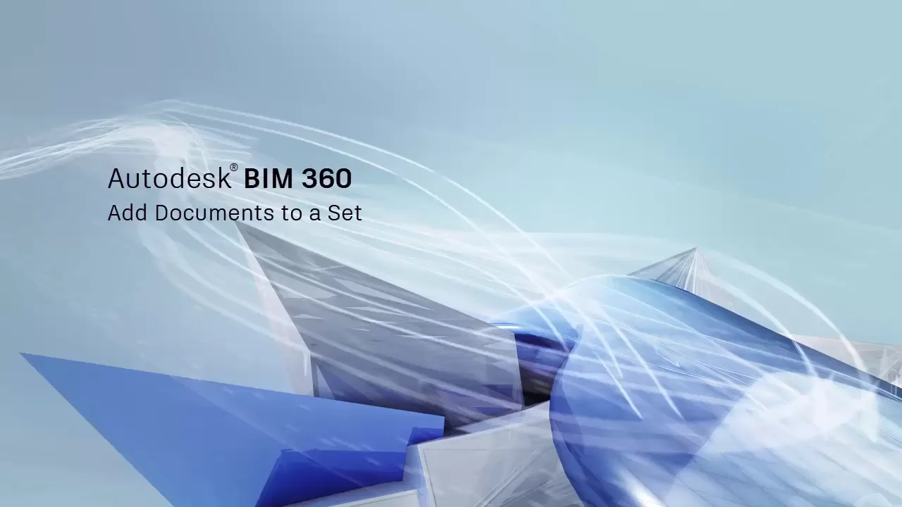

To add the document versions to a set:
Click Set not specified.
Choose Publish to a new set to create a new set (project administrators only). If you choose this option, provide a Set name. The Issuance date is optional.
Optionally, choose Publish to an existing set if your set already exists.
Tip: If you have multiple sets, use the search box to quickly find the set you need.Click Continue.
Tip: See Document Sets for more information.
You can also watch this video to learn more about how to add documents to a set.
