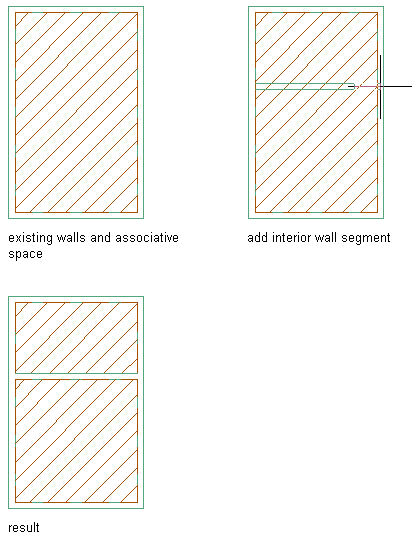

Associative spaces can be divided by adding new boundary objects. If you activated the automatic update of associative spaces, the update is run automatically.
Note: Verify that the new boundary object has its Bound Spaces property set to Yes before the space will be divided.

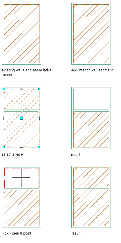

Manually dividing associative spaces
- Verify that the automatic update of associative spaces is deactivated.
- Create a new boundary object to divide the existing space.
The space object now spans 2 sets of boundary objects.
- Select the space, and click
The existing space is updated to fit into one of the 2 sets.
- Create a new associative space in the empty set.
