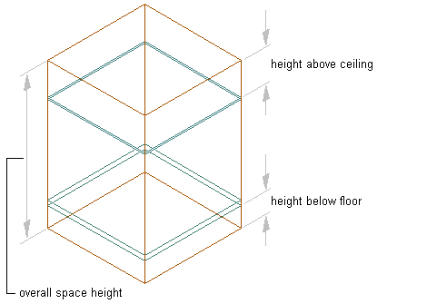

Space height components

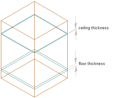

Space ceiling and floor components

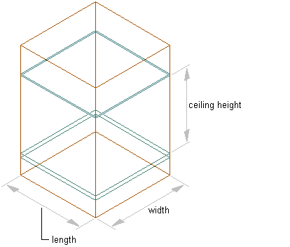

Additional space dimension components
