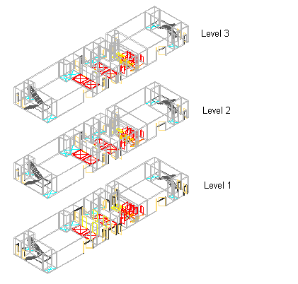

3D view of copied levels with assigned constructs
When you create a new level, it is empty and has no constructs assigned. After you have assigned constructs to the level, you can copy that level and its constructs within the building. For example, perhaps you have created a first-floor level and assigned 3 apartment constructs to it. To create a second-floor level with exactly the same layout, you can copy and paste the first level with its apartment constructs and rename it “Second Floor.”
