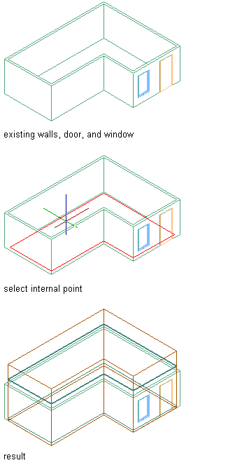

Generating an extruded 3D space from walls
As a special case, you can generate an associative 2D or extruded 3D space from the outline of an object in a drawing. In this case, the object outline will be used as the boundary of the new space. For example, if you generate spaces from wall outlines, spaces will be generated from the wall outline.
Walls (left) and space generated from wall outlines (right)

- In the drawing, generate the spaces:
If you want to… Then… generate a 3D freeform space Enter G (Generate all). generate a 2D or extruded 3D space use one of the following options: - Enter G (Generate all) to generate spaces for all visible boundaries.
- Pick inside closed boundaries in order to generate spaces for them.
