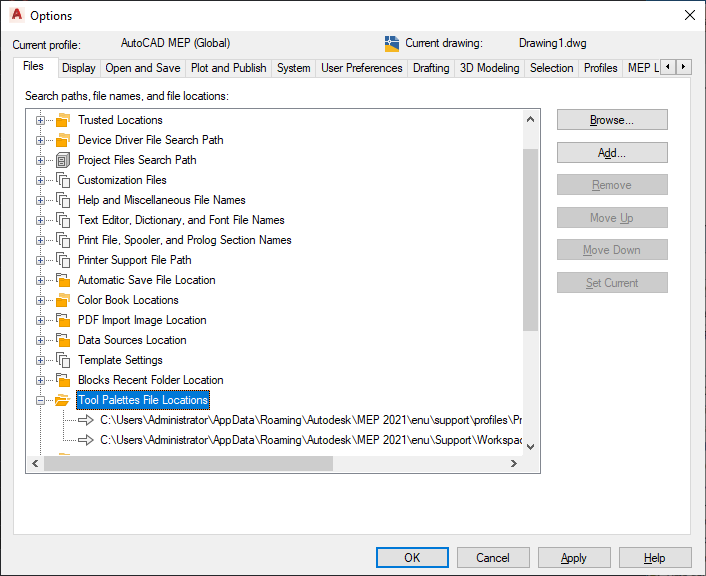

The tool palette set is the collection of tool palettes specified for the current profile in the Tool Palettes File Locations setting.
  • Click Options.
  • In the Options dialog box, click the Files tab.
