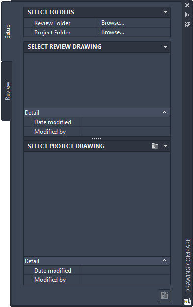

The Setup tab of the Drawing Compare palette is where you specify the context in which drawings are matched and analyzed. Under Select Folders, the review folder contains updated or revised drawings, and the project folder contains the original version of the drawing files. All the project drawings must be contained within the same top-level folder to provide the correct context.
The matching and analyzing process looks at each review drawing to verify whether it is a modified version of a project drawing. If so, the 2 drawing files are matched.
  1. Click Utilities Drawing Compare.
  2. On the Setup tab, for Review Folder, click Browse , navigate to the folder containing project drawings, and select it.
    Drawing files in this folder are displayed alphabetically in the Select Review Drawing pane. These files include host drawings and any drawings nested within them as external references (xrefs).

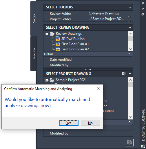

  3. For Project Folder, click Browse , navigate to the folder containing project drawings, and select it.
    The Confirm Automatic Matching and Analyzing dialog box displays.
    Note: The automatic matching and analyzing option is strongly recommended for most use cases. Match drawings manually only when a review drawing has been renamed, or if you want to compare a smaller set of drawings.
  4. Match review drawings to project drawings.
    If you want to… Then…
    let Drawing Compare automatically match all the review drawings against all of the project drawings in these folders click Yes.
    The Automatically Matching and Analyzing Drawings progress bar displays. The software matches drawings by file name.
    select a different project folder for Project Folder before automatically matching click No, and under Select Folders, browse to the folder that contains project drawings for Project Folder. Click Yes when the Confirm Automatic Matching and Analyzing dialog box displays.
