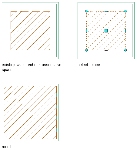

If you make a non-associative space associative, the software checks if a valid set of enclosing boundary objects can be found. If this is so, the space is made associative to them and the geometry is updated accordingly.

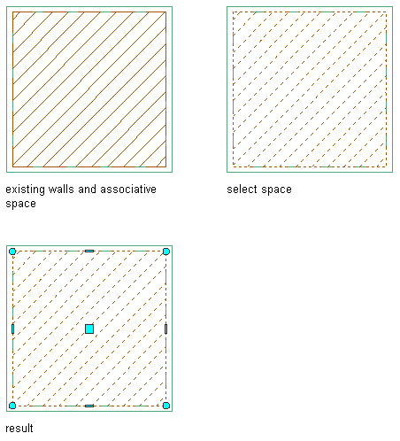

Making a space associative to boundary walls
If you make an associative space non-associative, the space is disconnected from its boundary objects. The space geometry retains its current shape after the associativity is deactivated, but is grip-editable.
Removing the associativity of a space to the boundary walls
Making an associative space non-associative

Making a non-associative space associative
  1. Select the space you want to make associative to boundary objects.
  2. Click Space tabModify panelMake Associative.
    If a valid set of boundary objects is detected, the space geometry is updated to the boundary of these objects, and the Associative property on the Properties palette is set to Yes.
    If no valid set of boundary objects is detected, the space geometry remains unchanged and the Associative property on the Properties palette remains read-only and set to No.
