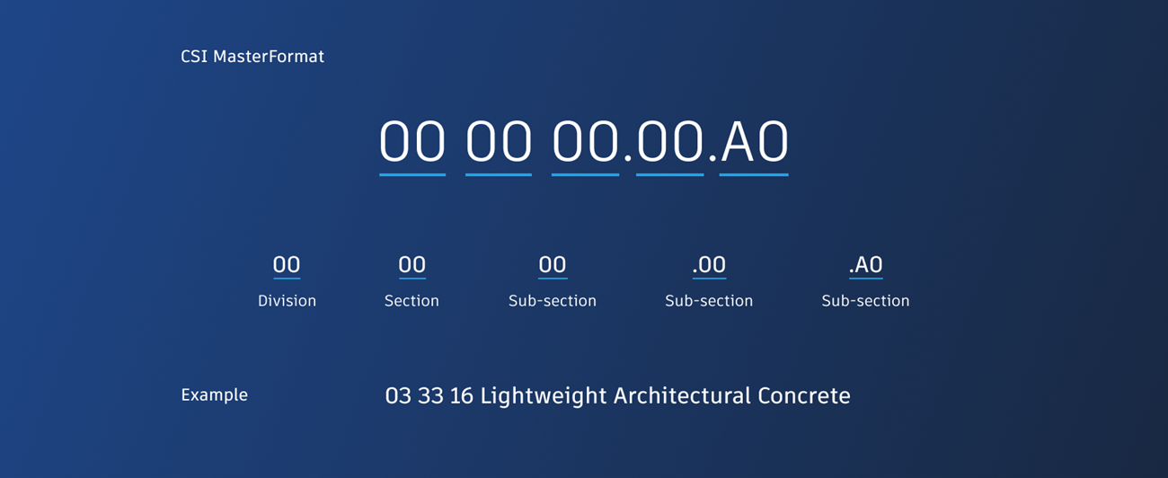

CSI MasterFormat
Typically used for projects in North America, MasterFormat is a primary list of divisions, sections, and subsections for organizing construction documents such as specifications, bidding procedures, or work results.

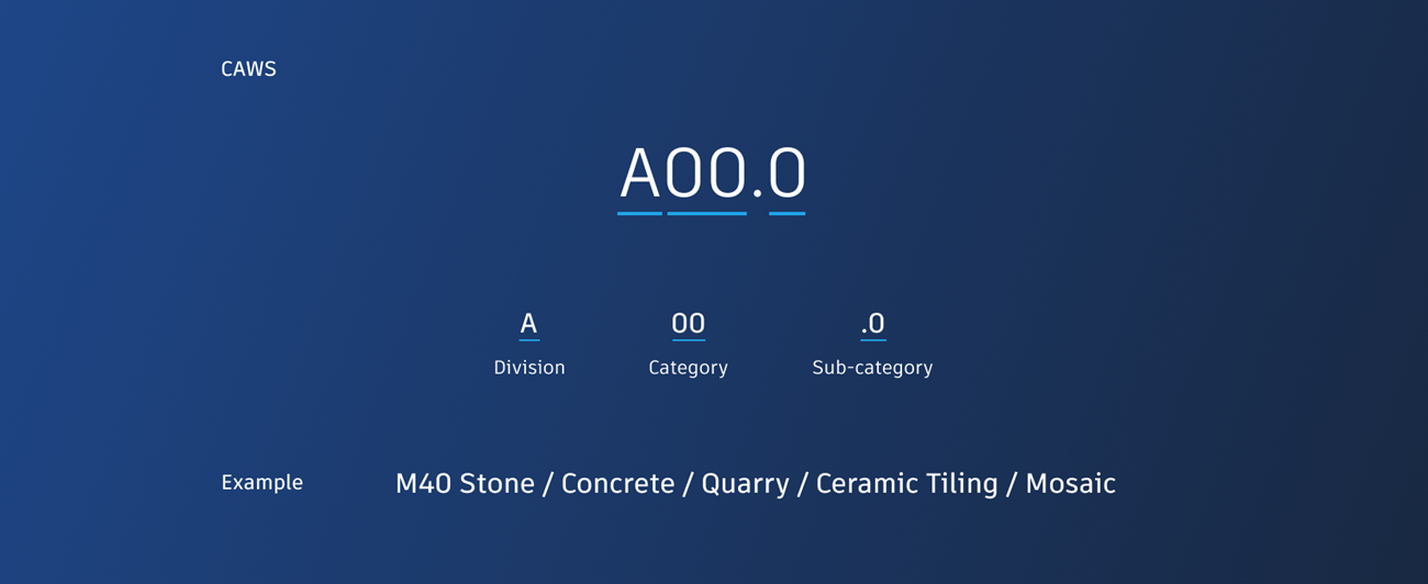

CAWS
The CAWS format is typically used in Europe, providing a consistent arrangement for project specifications and bills of quantities. The format comes with 24 main categories, over 300 sub-categories, and multiple sections that provide details for each category.

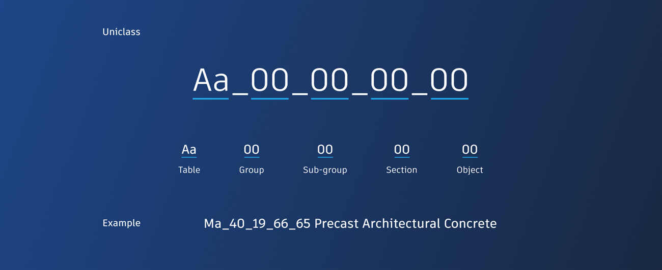

Uniclass
The Uniclass format is a unified system of 16 tables used for organizing construction specifications and managing project information. The format can be used for all aspects of the design and construction process. The standard is typically used to organize and communicate specifications, library materials, cost information, and structuring product literature. See Uniclass construction classification for details about tables and codes.
