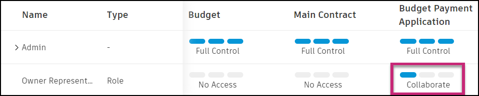

To enable an owner to collaborate in Cost Management, set the Collaborate permission for them for the budget payment applications. Learn more about permissions in Cost Management.

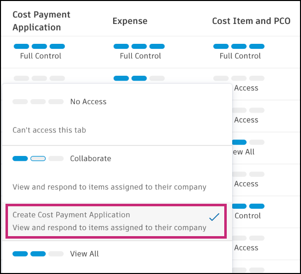

To enable suppliers to collaborate in Cost Management, set the Collaborate permission for them for the cost payment applications. What's more, with Create Cost Payment Application permission, they are able to create cost payment applications linked with their company's contracts. Learn more about permissions in Cost Management.
