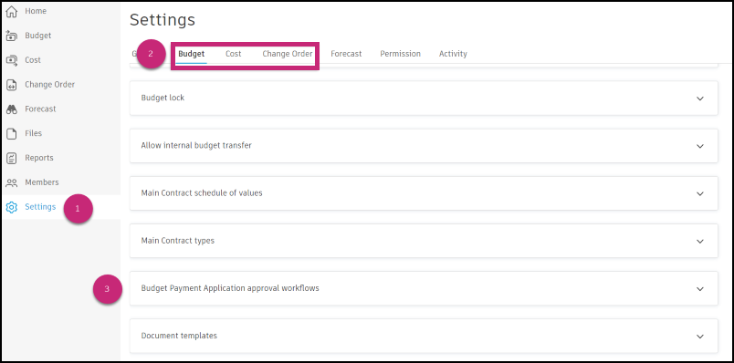

  1. Select the Settings tool Settings tool icon from the left navigation.
  2. Switch to the:
    • Budget tab for budget payment applications and internal budget transfers.
    • Cost tab for contracts, cost payment applications, or expenses.
    • Change Order tab for OCOs or SCOs.
  3. Click the relevant drop-down menu depending on the type of approval workflow that you want to create:
    • Budget Payment Application Approval Workflows
    • Internal Budget Transfers
    • Contract Approval Workflows
    • Cost Payment Application Approval Workflows
    • Expense Approval Workflows
    • OCO Approval Workflows
    • SCO Approval Workflows
    Settings for approval workflows

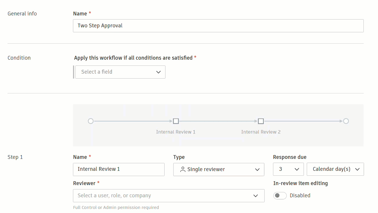

  5. Select the number of approval steps, and click Next.

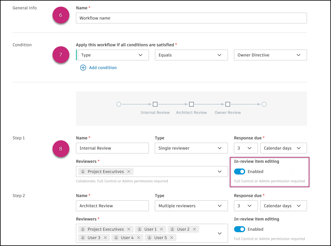

  6. Enter a name for the workflow.
  7. Set conditions using drop-down menus to activate the workflow automatically. For example, activate when the approved value exceeds $10,000. Conditions vary by workflow type.
    Tip: Use custom attribute types (text, number, drop-down, checkbox) to route workflows. Learn more about custom attributes.
    Example of approval conditions
  8. Assign reviewers for each step. For each step, you can:
    • Add a step name (for example, Internal Review).
    • Set reviewer type (single or multiple). Specify if all members must review or set a minimum number.
    • Determine response due time.
    • Choose reviewers (member, role, or company). Reviewers must have Full Control or Admin permissions.
    • Decide if reviewers can edit items under review.
      Note: Workflow templates prefill the Reviewer Type field. For multistep reviews, customize as needed.

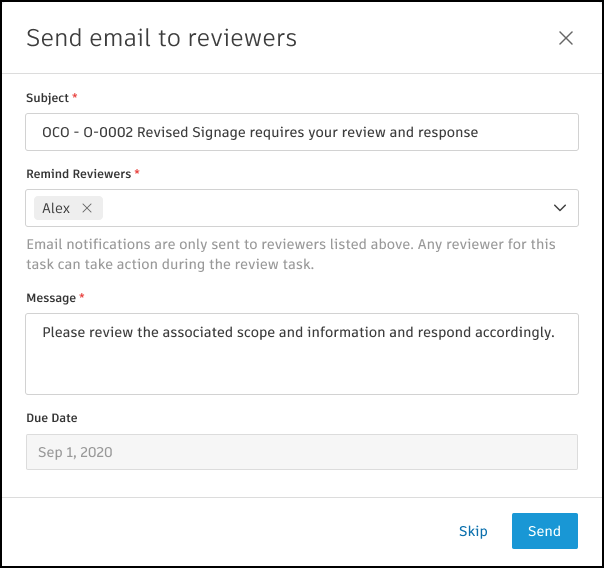

Example: Reviewer Notifications and Submission for Signature
When an item meets workflow conditions, a dialog box appears, detailing the workflow and allowing comments.
Tip: After setting up the approval workflow, you can view all reviewers across previous, current, and upcoming steps. You can send reminders to future reviewers before their review is due.
Approval workflow send dialog

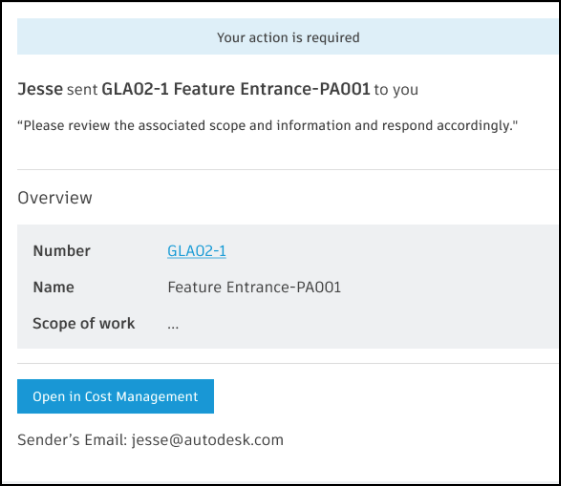

As the item progresses, reviewers are notified through email.
Approval workflow email notification
