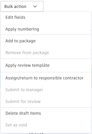

To perform bulk actions:
- Select multiple submittal items using the checkboxes. This will display the bulk actions drop-down menu.
- Choose an action from the drop-down menu.
- Confirm the action.
Submittal Bulk Actions
Edit Fields
Change the responsible contractor, due dates, manager, priority, type, etc. across multiple items.
Apply Numbering
Apply numbering to multiple unnumbered submittal items by choosing a starting number. The assigned numbers will follow in sequence from the chosen starting point, adjusting as necessary to align with project numbering settings and to avoid conflicts with existing numbers.
Example: If starting number 7 is selected and 8 is already taken, the sequence will be 7, 9, 10, and so on.
To learn more about numbering, see Submittal Custom Numbering.
Add to Package
Select several items and add them to the same package.
Remove from Package
Take multiple submittals out of their existing packages.
Apply review template
Apply existing review template to multiple submittal items.
Assign/Return to responsible contractor
Assign multiple items to a single contractor. This action requires the items to be in DRAFT or OPEN status, and not in a package.
Submit to Submittal manager
Send multiple items to a single manager. This action changes the status to OPEN and is visible to other members.
Submit for Review
Send several items to the same reviewer.
Delete draft items
Delete multiple draft items.
Set as Void
Mark multiple submittals as void.
