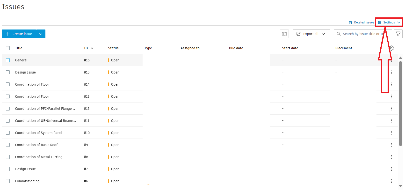

To add custom attributes for Issues in Forma, we suggest the following steps:
  1. Go to Forma Data Management > Issues > Settings
    Image of Issue Settings in Forma
  2. Select Custom field > Create Custom field
