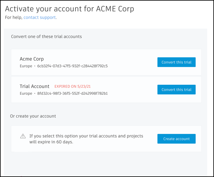

  2. If you are the administrator of only one team and have one trial, the conversion process is automatic and you are taken to your activated account. If you are an administrator of multiple teams, select the team you would like to activate.
  3. If you have multiple trials, select the trial account that you would like to convert or create an account to discard your trial projects and members.
Note: If your account was started in the wrong region you may want to create an account. You can provide a name and a region for the data to be hosted while creating an account. You can't convert a trial project to a different data center.

Question 3: I do not see my trial account in the list, why?
Answer 3A: You may not be an administrator on the trial account you are trying to convert, ask another administrator to verify you are an administrator on the account.
Answer 3B: Your trial has been expired for more than 30 days and can't be converted any longer.
Question 4: The trial that got converted is not the right one, what do I do?
Answer 4: If the wrong trial was converted reach out to technical support.
