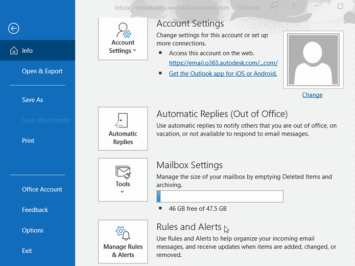

Outlook
Follow these steps to edit your Outlook rule:
  1. Open Outlook.
  2. Click File > Manage Rules and Alerts.
  3. Click Change Rule > Edit Rule Settings.

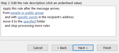

  4. Uncheck the from people or public group box.
  5. Check the with specific words in the recipient's address box, and then in the rule description dialog, click the specific words link.
  6. Type in "@acc.autodesk", click Add, and then click OK.

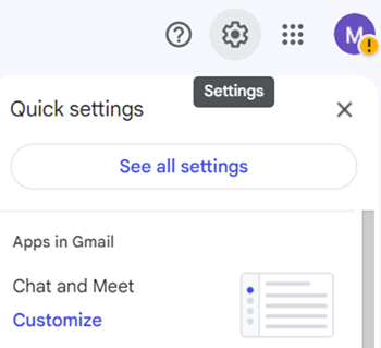

Gmail
  1. Open Gmail.
  2. At the top right, click Settings > See all settings.

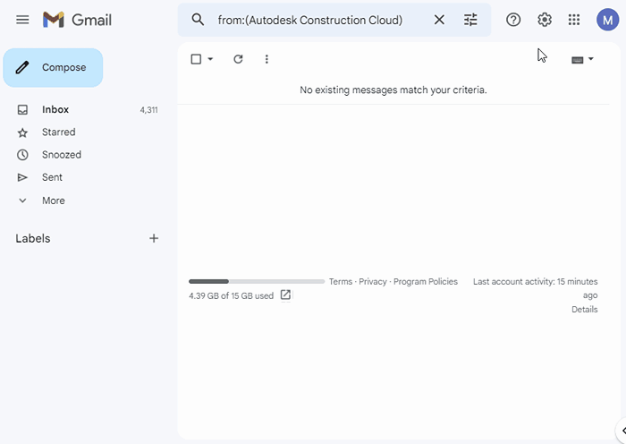

  3. Click Filters and Blocked Addresses, and then click edit next to the filter you want to modify.
  4. Move your filtering criteria from the From field to the Has the words field, as shown below.
  5. Click Continue.
  6. Select a box next to an action you want to perform for the message that matches your criteria.
  7. Click Update filter.
